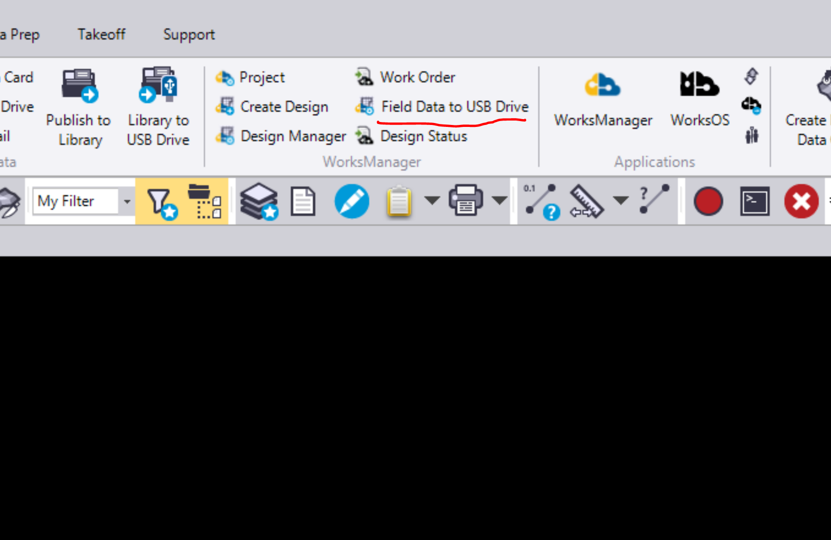

    When exporting out your information which method are you using? Is it "User defined","Surface" or "3D-linework"? Also as a possible work around you could use the "Field Data to USB" option and this will generate all of your files in their respective folders.
