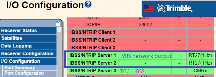

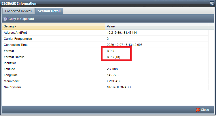

    In down under we didn't have any issues the last two days.
    The last time we had that kind of issue was last year when the base with FW older than 5.50 reported the wrong stream format to TCC.
    But that was a very specific FW bug in connection with additional data being streamed to the VRS network, which our base is part of. Those streams are RT format and for some reason the IBSS stream, from time to time, got the same flag, no matter in which order they were setup on the base.
    The stream was actually CMRx, but the flag was wrong. Machines don't check the flag, SCS900/Siteworks does.
    Prior to FW5.50 the only fix was to disabled the stream on the base and re-enable it. That did reset the flag on TCC.
