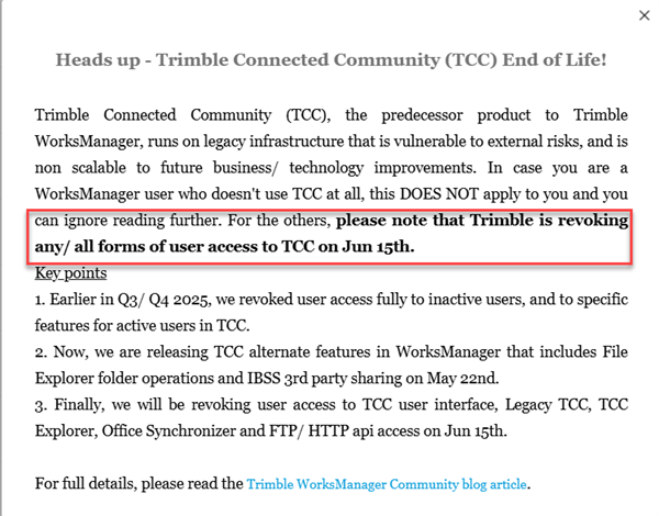

    I opened WorksManager this morning and got the message below.
    The only reason I'm still using TCC is to move work orders between tablets. Adding this feature to WorksManager has been requested on this forum many times.
    Is there a timeline for this?

    The upcoming WorksManager release on May 22 introduces folder-level operations. This update enables the moving and copying of work orders across data collectors, providing a direct alternative to legacy TCC workflows.
    Please provide feedback by the end of that week if you find the new solution is not performing effectively or efficiently.

    The WorksManager file explorer currently supports move and copy functions, enabling the transfer of work orders across various data collectors. However, the upload and download folders are not yet available.
