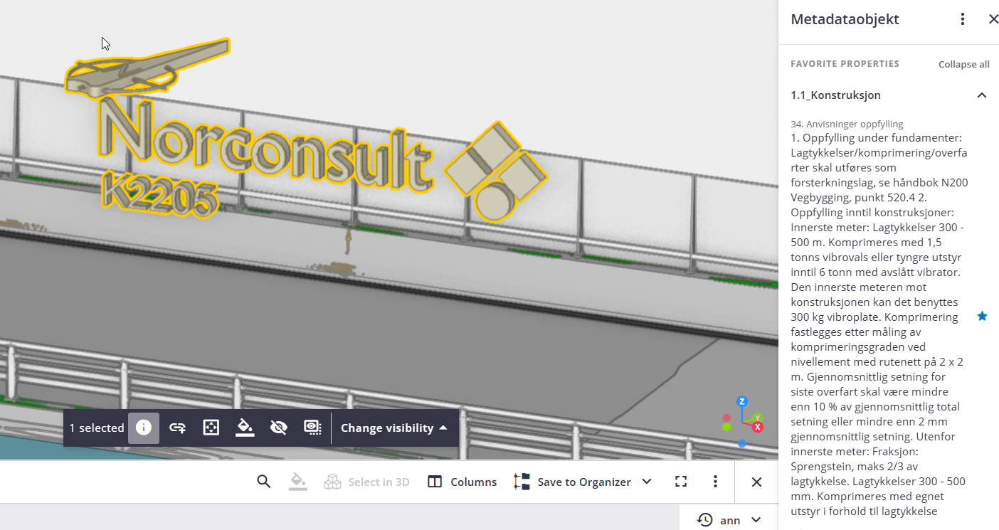

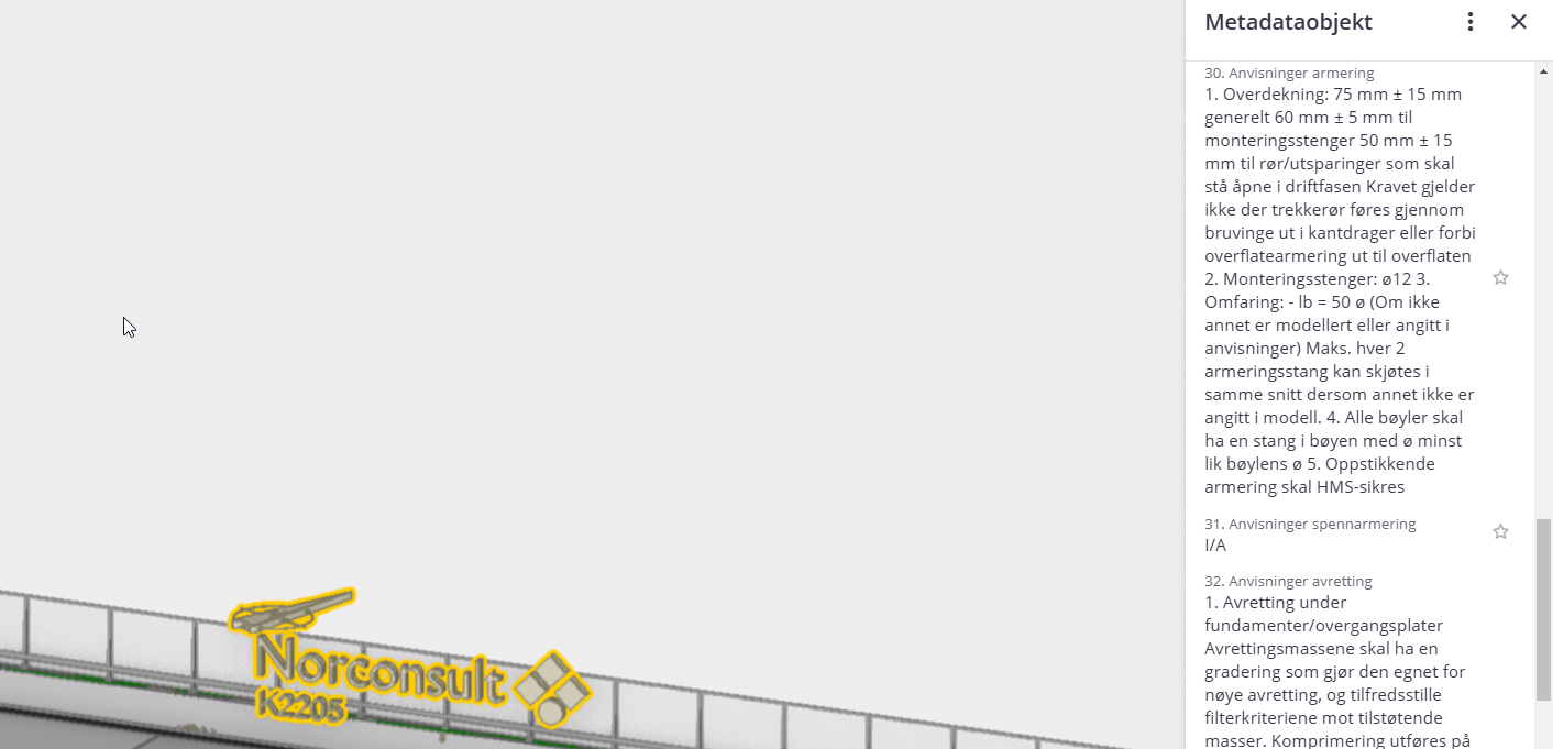

    Hei,
    i suspect that its a frontend issue since both the desktop app and exported data shows this correctly as shown in the pictures below
    Trimble connect for browser dont show newline breaks in properties
    desktop app does
