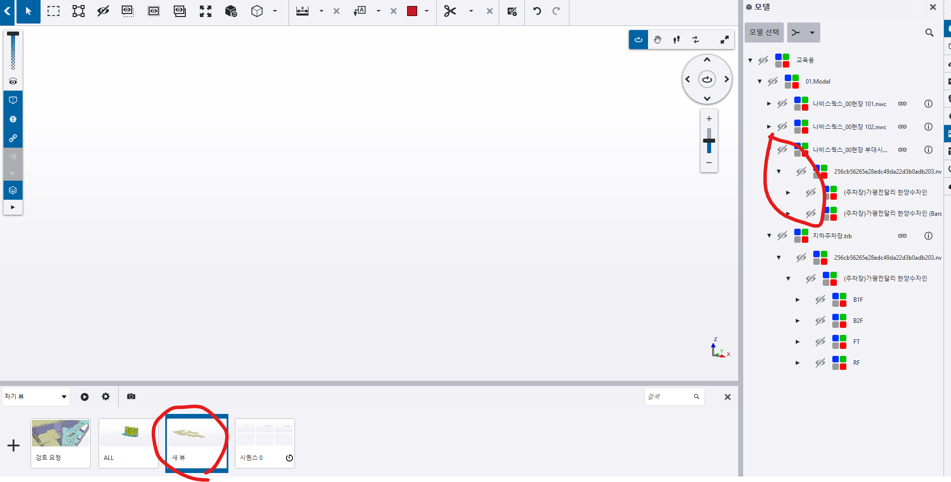

I'm experiencing the same problem when using Trimble Connect for Windows. The camera position in the Saved View loads correctly, but the visibility settings for objects are not applied at all.
Have you found a workaround or a solution for this issue?

Subject: Trimble Connect for Windows - Saved View does not retain Object Visibility (Layer On/Off Status)
I am using Trimble Connect for Windows (Desktop App).
When creating a Saved View, I turned certain layers (objects) on or off through the Object Tree before saving the View.
However, when I load the Saved View,
the camera position (Viewpoint) is restored correctly,
but the object visibility status (Visibility State) is not reflected at all.
As a result, all objects either reappear or disappear, regardless of the visibility settings I applied before saving.
