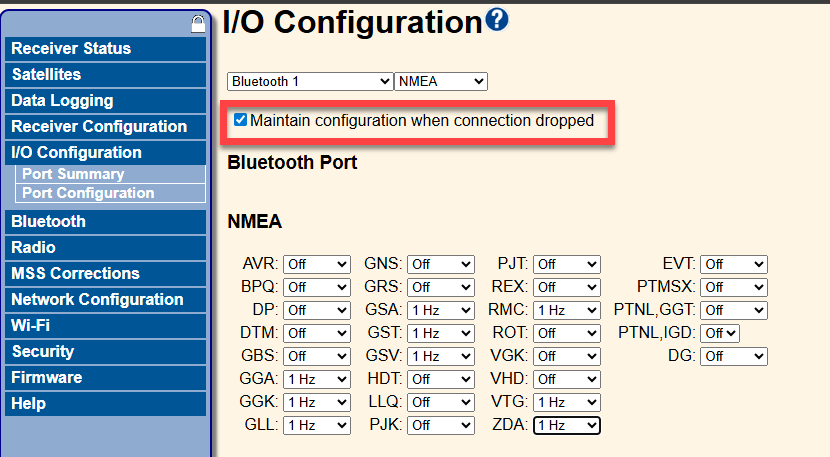

    Hi Gaston,  one can also maintain NMEA messages upon disconnect by checking this check box in the R2s WebUI under I/O Configuration / Bluetooth / NMEA:
    Ryan Scott
