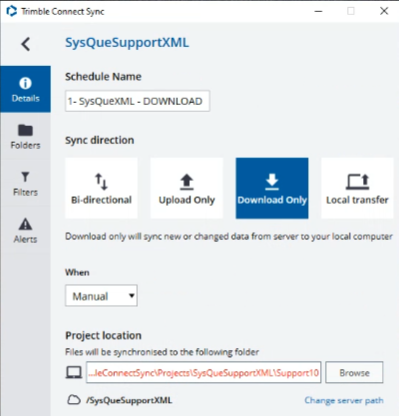

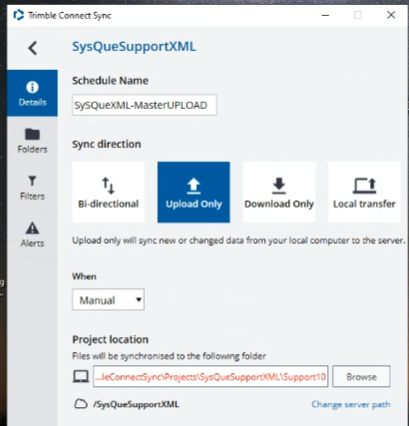

    Savage's setup (with matching paths)... is this "project":
    With DOWNLOAD and UPLOAD SYNCs  (I think it would be better to refer to these as SYNC jobs, not "Schedules" – for several reasons, not the least of which is that a MANUAL SYNC is by definition... not scheduled
    D:\TrimbleConnectSync\Projects\SysQueSupportXML\Support10

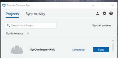

    And NOW ... I find that viewing the existing schedules completely PREVENTS the VIEWING – let along modification of the Sync job -
    ... clicking on Folders, Filters, or Alerts – completely BLOCKS access to that information:
    Displaying:
    This is completely unacceptable.
