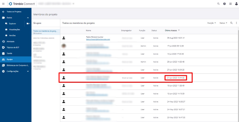

    I will show an example below:
    • This employee's contract ended in January 2023 and his email with our organization's domain was deactivated on the same date.
    • However, in the "Project Members" section, it shows that this employee logged in TC in June 2023.
    My point is, is there any other procedure or management tool we can use so I don't have to go into each of the hundreds of projects to remove THIS USER and ALL OTHER USERS who have their contracts ended?

    Hi Fabio,
    Unfortunately , we don't have a mechanism to remove user from multiple projects simultaneously.

    Hello Fabio,
    I suggest you look into federating your companies user authentication systems with Trimble Identity.
    With Federation set up, your employees will sign into Trimble Connect using your companies authentication.
    As employees leave your company the action of disabling the employee in your authentication system will prevent future sign in.
    NOTE: The employees will still be project invitees but will be unable to get past your companies authentication system.
    Search for Federation in this help portal for further details .

    Hello Fabio,
    You can utilize the Trimble Connect API to iterate over all projects, apply conditions to remove users, or pass a list of non-active users. In my case, we use Python requests.
