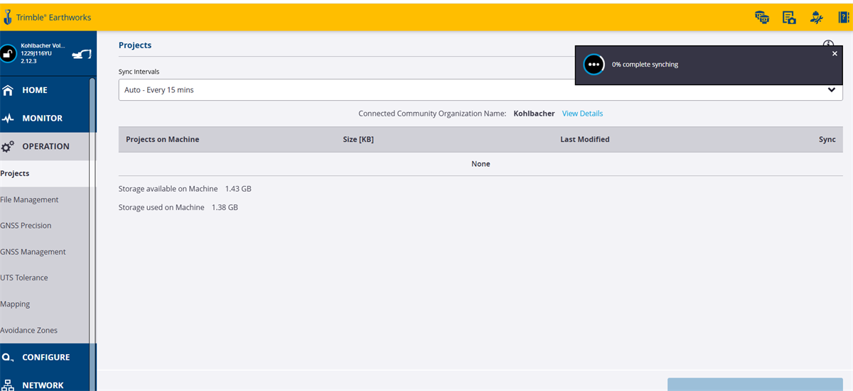

    Whats happening again with WM? Several customers calling that they lost all Projects on their machines? Also not able to sync again
    FIX IT PLEASE

    about 20 machines on different accounts
