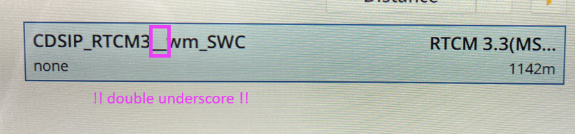

    Worksmanager and Trimbletools show this as the mount point.
    But that is wrong!
    Looking at Trimble Access it shows the following as mount point when connecting to that stream.
    With that one DJI pilot 2 shows the base position, the satellites oddly stay at zero count but it seems to converge. Accommodation is too far away from site. I'll need to confirm on site tomorrow if it's able to fix it properly.

    I agree the double __ is a little confusing and are pleased you got it going.
    The __wm_SWC you see when you are doing the 3rd party flow, you do not see it if you are using the normal device in WorksManager flow (unless you are using a shared base station)
    It is done that way so that every base station name is unique.
