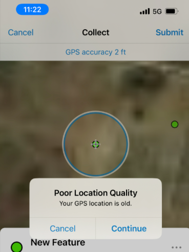

Subject: "Your GPS location is old" in Field Maps connected to a DA2
Thanks Mark!
When you say "Ensure the USB cable is reliably inserted at both ends", are you suggesting it's a low power issue with the DA2? Thanks for the suggestion to reach out to the dealer. We will do that.
Thanks!
Anne Dunckel
Sent: 08-21-2025 18:58
From: Mark Kellaway
Hi Anne,
This could be a number of things, but some additional items to check:
- Ensure the USB cable is reliably inserted at both ends
- Try a different power bank
- When Field Maps shows the error check to see if the DA2 is still connected by Bluetooth in the System settings
It's probably worth you raising this with your Trimble dealer beyond the above suggestions, they will be able to troubleshoot with you and will escalate to Trimble as needed.
