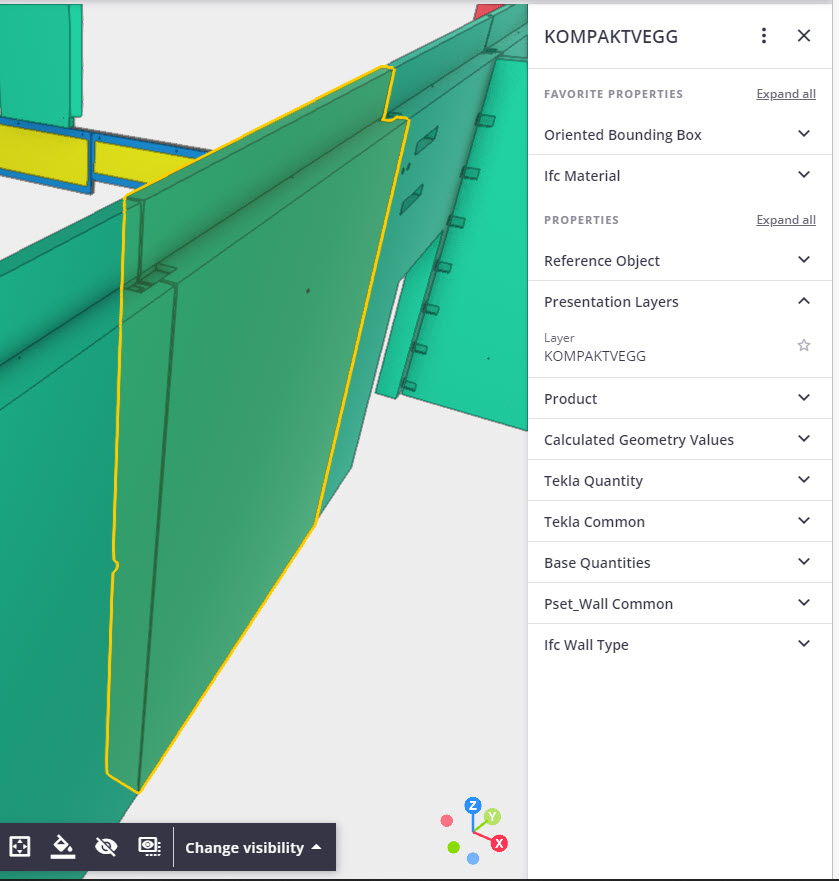

Thomas Bøhlerengen posted 03-28-2023 01:39
We have an IFC file that not all the attributes are shown in Trimble Connect Browser version.
In the Desktop version f.ex. the property group Tekla Assembly are shown on the object. TC states that this is "Values inherited from higher level assembly".
In the Browser version I am not able to find these attributes. Anyone know where to find the attributes?
Se attached screen shots.

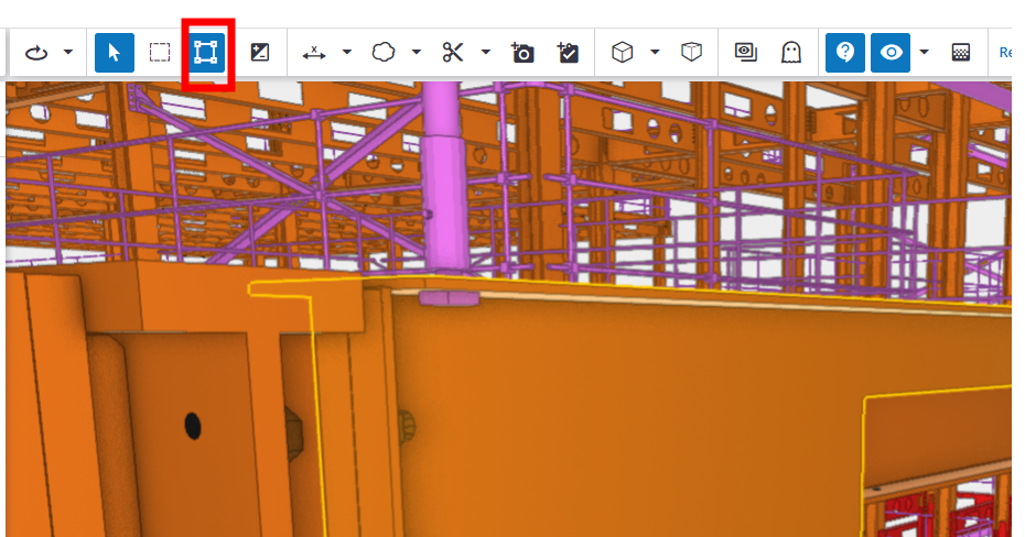

Hi Thomas!
You need to select the assembly level and then inquire the element to see the assembly properties
