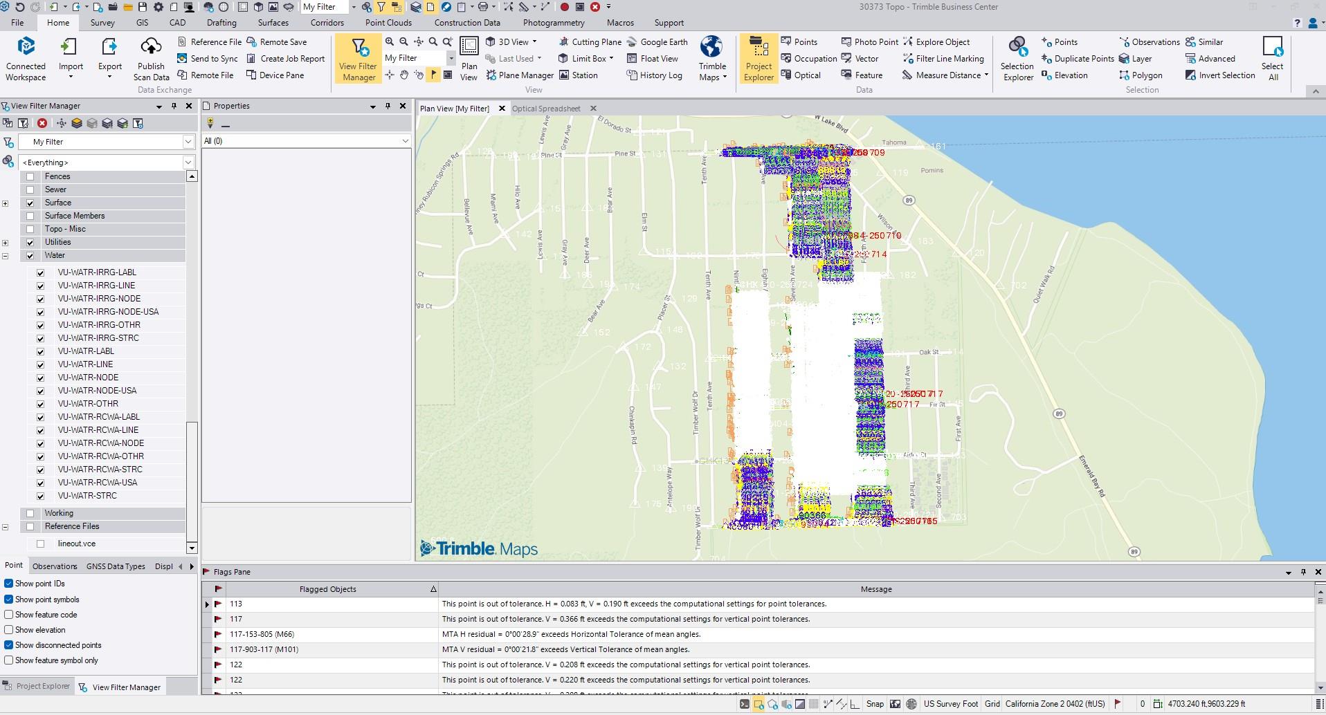

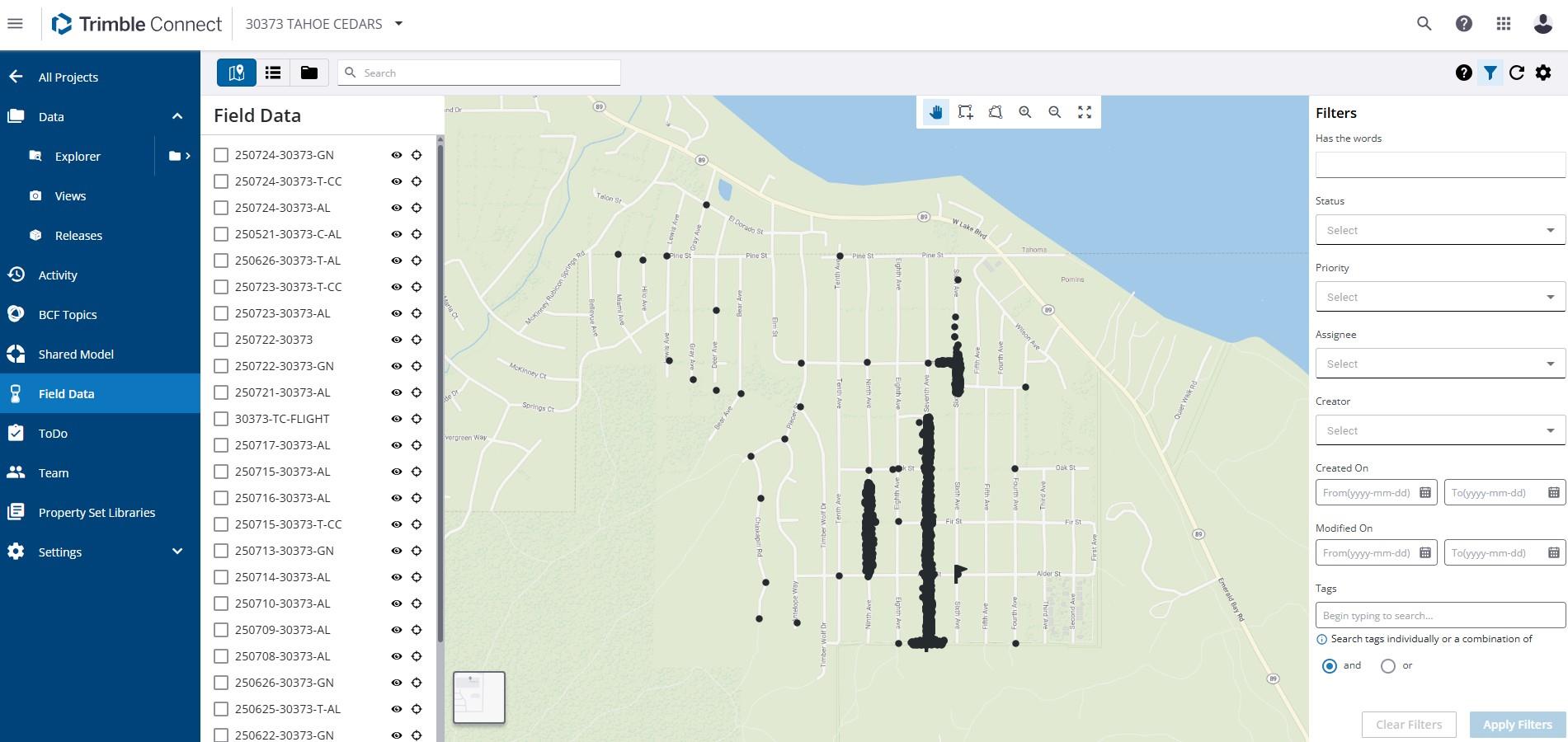

I've got about 18 days of field work on one job, but only maybe 4 days worth of data is being displayed, see attached.  I've also included an image from TBC showing how much more data there actually is.  Everything is being ran through connect.  It doesn't appear to be isolated to certain TSC7 controllers, it appears that there is data shown from all three controllers, just not all of it.  Maybe showing 20% of existing data.

Anyone know what's up?  I appreciate the help!  Thanks.

Hello George,
The feature code processing only acts on jobs that have been moved out of status New.
Has the Job Status been changed from New to something else? ie "In progress", "Field Work Complete" or "QA Complete" / "Closed"
It maybe that some of your crew change status and others don't.
We are looking to automate the status change when Survey is started but currently it needs to be set manually.
You can change the status in Access, Field Data extension and Sync Manager. TBC is exploring enabling the same.
Any lack of linework may be because the feature code processing needs a feature code library to act on.
You can add a feature code library to the project by clicking on the gear icon in the top right of the Field Data extension viewer.
Also, Feature Extraction does not act on scale factor only jobs
