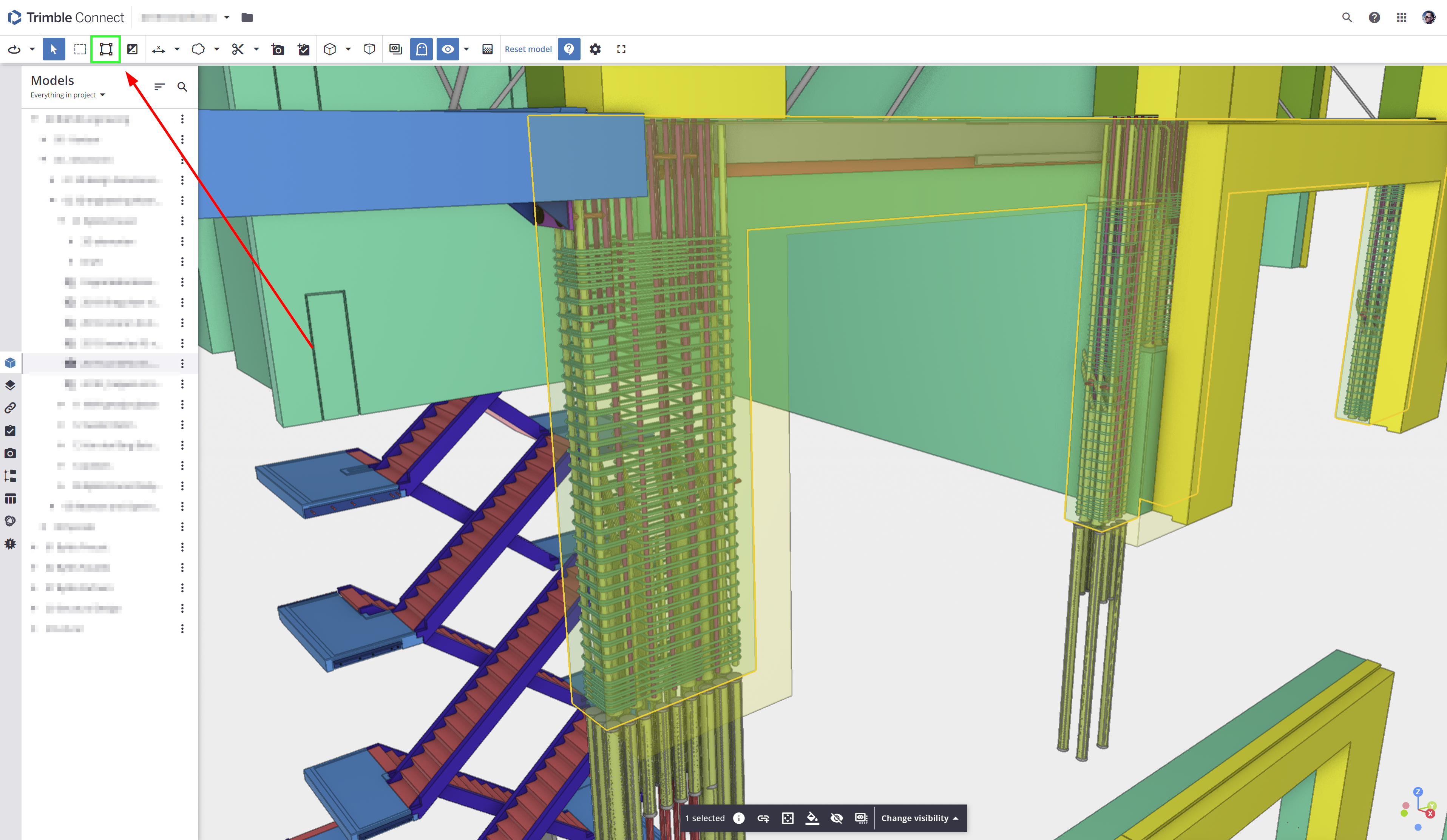

Hi, While writing out using Tekla 2020 we were able to hide walls in Trimble Connect model view and see/select the reinforcement but with Tekla 2022 the reinforcement is hiding when the part is hidden and we're unable to select and enquire the reinforcement types.
See the wall above, if I hide the class 1 part it also hides off the reinforcement that is attached to it even when in part selection mode. I would want to only hide the solid class 1 panel and be able to enquire on the reinforcement that is in the model.

I can't judge your selection settings in Connect. I assume you export your IFC (or maybe it is an TRB of TEKLA file) in Assembly mode. Probably it could be the case your need to uncheck the Assembly Selection.
