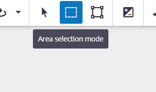

Thanks for sharing the feedback. It is currently not possible to add the properties to the whole model at the beginning of the project.
At the moment, you could try the "Area selection mode" which lets you select the entire model  and subsequently add the properties.
