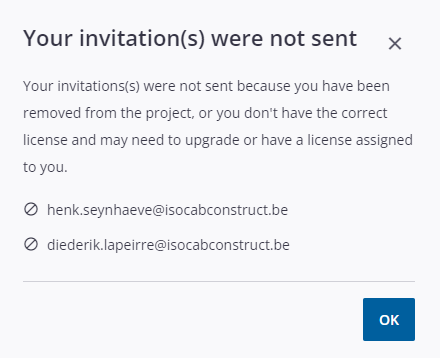

We activated our Trimble Business account, created a project and now we are inviting our company membres to this project.
We are able to add 6 project membres (Admins) but when we try to add more Users , we have a notification that we have not the correct license.
Please can we get your help for this?
Ray Bagley's profile image
Ray Bagley
In TC Web, go to Settings > Project Details. In the "Project Ownership" drop-down, select your Trimble Connect Business license.  That should remove the limitation on sending invitations to that project.
