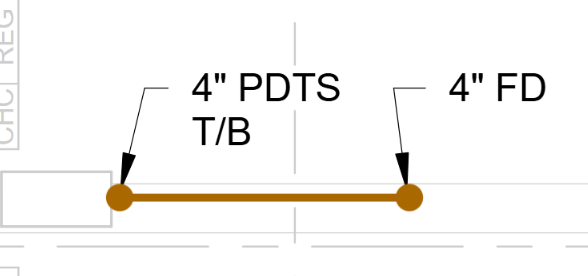

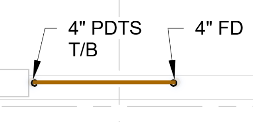

Is there a way to not have points/counts show when starting a length takeoff? When starting a length takeoff, I only need the line to show since I will be adding my own fittings (points/counts) after. Is there a way to turn the points off? I know you can turn it off after finishing the length takeoff in the annotations detail menu, but I want it off by default. This wasn't an issue for the old livecount as length takeoff styles and count takeoff styles were two separate things, and the styles can be changed independently.
With points:
- Don't want this because those points are not connected to Accubid.
Heres a line with points. These points are only for looks as they are not tied to a count in accubid. (I dont want this)
Without points
- Just want a clean line only when doing length takeoffs. This way, I can add the fittings (Point/count) after that are connected with Accubid.
Just want a clean line only when doing length takeoffs. This way I can add the fittings (Point/count) after.

Press the "shift" key before clicking on the starting point, keep pressing "shift" on every point. This will tell the program that these points are not counted and will not appear. If you want to include a point, release the "shift" key.
