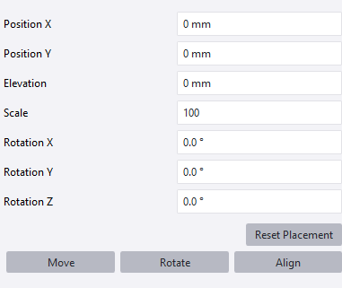

I often work with models in different coordinate systems. And until now it has not been any problem. I just adjust the positions to what I want then it stays there even if the model is updated.
But in the last week or two the new models i insert gets reset if I go to another project or restart Connect. The positions seem to get saved on the "for windows" application but I really want to use the desktop version since I also work with point clouds together with IFC-models.

I have exactly the same problem with a nwd-file, i set the x,y,z position to match the site coordinates and add an X-rotation of 90°.
After reopening the project everything has switched back to zero. :(

The position resets after 1 minute I put the values, and going back to zero again. But only on my local PC, it's going to the origin. In other people's Trimble models which are in the project already, their positions are correctly visible. Only on my local model, it is incorrect. I checked the browser Trimble model as well, and it is also correctly positioned in the web browser. I recently updated my software to "TrimbleConnectSetup-1.21.0.518-x64". Is it about this update?? Please help me solve this issue. I tried uninstalling and re-installing the software. Since I have updated my software to 1.21, I cannot install previous versions too, because when I install the previous version, it doesn't open my models and gives an error something like: "Model library cannot be opened in the previous version because it was saved in 1.21 version.".
