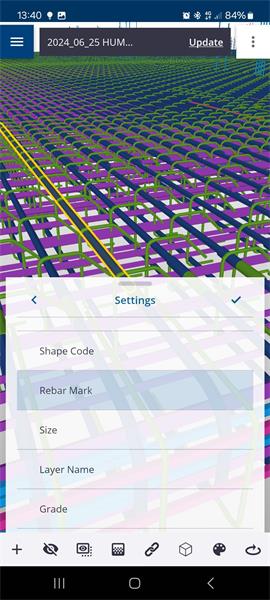

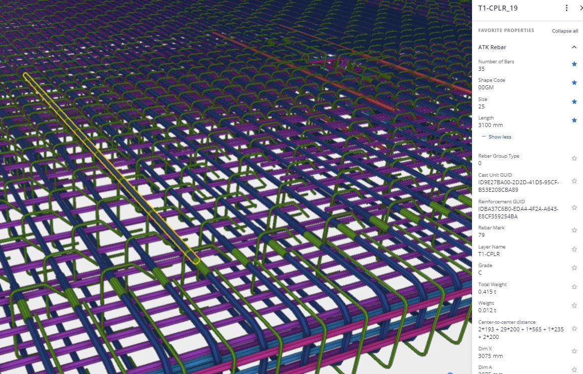

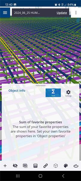

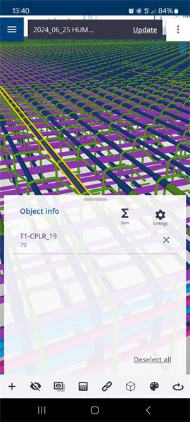

I'm not sure if there was any update for Trimble connect recently or someone has changed some settings but a view how object info is presenting has changed. After selecting rebar and going into object info/properties it usually was showing all relevant information (bar mark, shape code, dimensions, etc.). Currently it looks as in attached picture and does not allow to choose multiple settings or it is freezing the app when trying to select the item in object info screen. I've checked app though browser and all works fine there. I've checked old models and the issue is exactly this same. Following feedback I have from site all was fine last week. Perhaps anyone of you is facing similar issue and may be able to help in this matter?
object info - general view
TC - object info settings
TC - object info sum
TC - browser

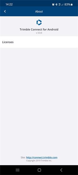

the issue is visible on Android and iOS version of Trimble connect for mobile. Most of the tablets we are using have auto-update turned on hence the issue may be related to the latest update but it is just a guess. We have 2 tablets which didn't have internet connection and they have not been updated yet. For those two Trimble Connect works fine (older app version). We are using v.3.0.0 of the app. Please see screenshot below.
