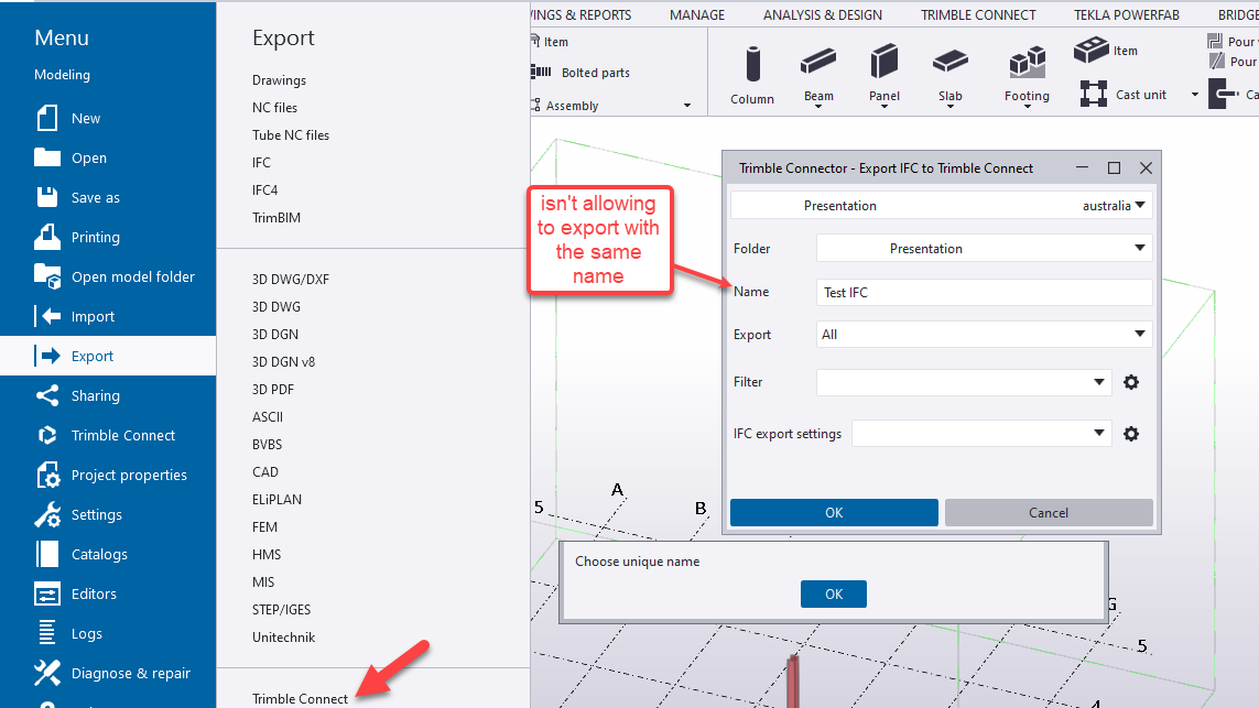

Hi Lee,
I might guess he is refering to the "Trimble Connector - Export IFC to Trimble Connect" from the export tab. It actually does not let you export with the same name with this method. To confirm thought.

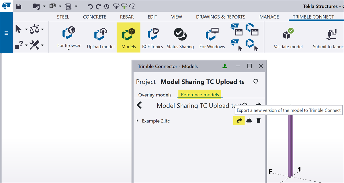

If you use the Trimble Connect export then once the IFC file is generated and upload you should go to the "Models" tab, find the upload and then just upload a new version.  It maintains the same name and settings so that you can track the versions in Trimble Connect as needed.
