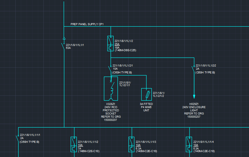

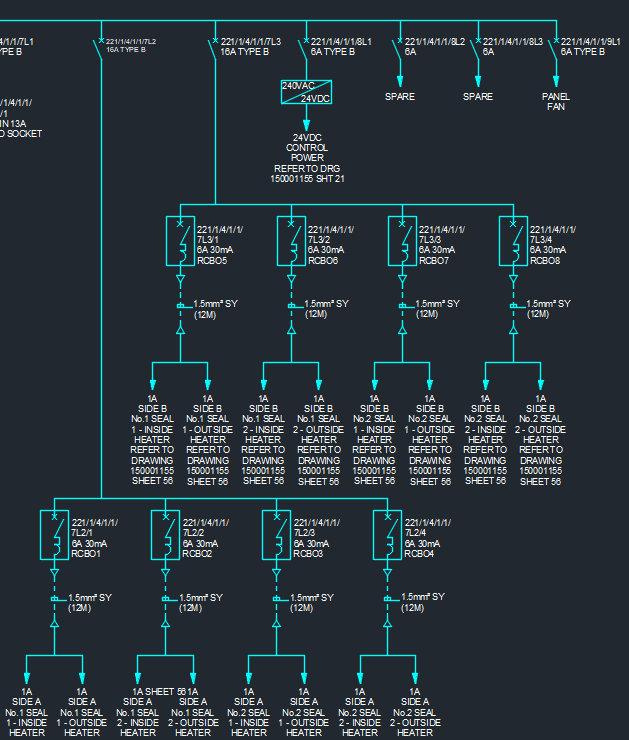

Hi, I have just joined this forum in the hope of getting a bit of guidance/help, but not sure if this is the correct place, so apologies if its not.
I am using ProDesign to build switches for the site I a working on, we have the license for 25 boards but I have hit that with still a few more boards to add. Some of these boards have been taken up by having a protective device feeding between 2 and 4 other protective devices (RCD sockets or panel protections for things like lights or fans), another one is sometimes a protective device may feed another protective device downstream, the only way I can see to add these devices is to show a distribution board fed from the initial device and then that feeding the extra device or devices, but this soon eats in to the 25 allowed board on the project.
I have added two pictures to try and explain it better, one shows a breaker feeding two separate devices, the other shows a breaker feeding four devices which are linked in a panel rather than a distribution board.
breaker feeding two devices
4 RCBO's daisy chained from a breaker
Surely there must be a better way of doing this so that the boards feature is only used for actual distribution boards (I tried adding a junction box instead but that only allows one cable to come from it so didn't help either.
Any help greatly appreciated.
