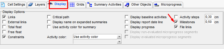

I sometimes use activities with the type hammock tasks to measure certain time in the project. Those activieties have a length of 0 and sometimes they get also duration 0. In this case (length and duration 0) the activity becomes a white rhombus. Is there a possibility to change the size, color or the shape of this symbol?
Furthermore, when using constrants for the links I have a similar problem with the flags. Is there a possibility to change the size or maybe also the symbol of the flags?
Thank you
Thorsten Jourdan-Balthasar's profile image
Thorsten Jourdan-Balthasar  Best Answer
Hi Georgi,
you may change the size of the milestone and probably the flag symbols in the display tab of the time-location cell:
You may not change the color/shape, sorry.
