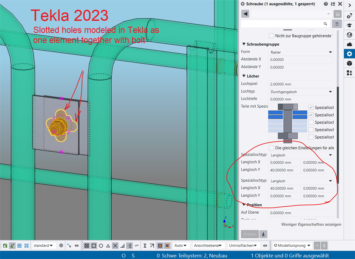

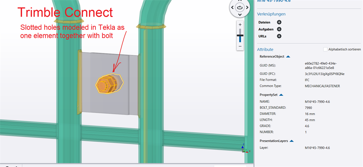

The slotted holes which are modeled in Tekla as one element together with the bolt (Screenshot 1) do not appear in Trimble Connect (Screenshot 2).

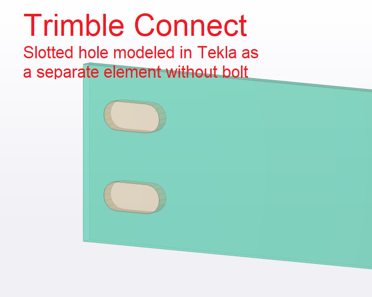

The slotted holes which are modeled as a separate element without bolt get shown correctly (Screenshot 3).
The holes look normal in IFC-Export.
Is it a problem with Connect viewer or can be adjusted in Tekla?
Screenshot 1:
Screenshot 2:
Screenshot 3:
