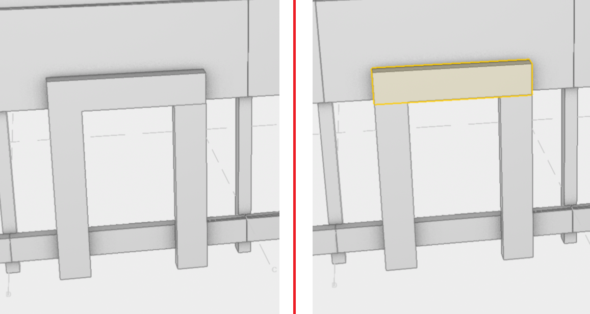

I've noticed some of our IFC's seem to have objects that are missing their edges.
As you can see in the picture below there are 2 different volumes that could be mistaken for one.
What could be the cause of this? The edges of both volumes obviously overlap but the same goes for the right side, where everything is rendered as you'd expect.

For future reference: Edge and Firefox rendered the model properly. I removed Chrome and reinstalled it and this seems to have fixed the problem for now.
Helpdesk mentioned that their Mobile TC app had the same problem when rendering my IFC, so it's not specific to my PC.
