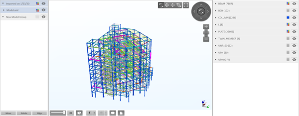

Hello, I used to have Tekla BIMsight which can open my XML model.
I want to exported to IFC so that i can work on it with another programs. - I tried to import the XML model to Trimble connect but it cannot open it. - the new version of Tekla structures even cannot deal with my file. I managed to find Tekla structures 21 ( the old version of 2015) and managed to import the model to it (after converting the model to a TBP file using Tekla BIMsight).

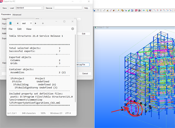

Tekla structures defines my model as a reference model, so when i try to export it it doesn't !
I draw another columns as in the picture below to check, the program export them and export the grid, but it wont export my model.

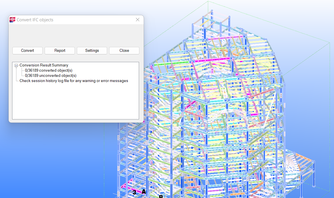

you might have to convert the XML back to native parts model in Structures, then export that model to IFC.
Thank you Mr.Ruben for repalying I already tried, and it wont convert it as shown :
