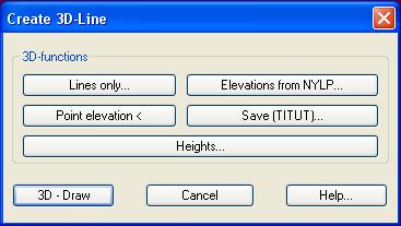

The dialog box 'Create 3D Line' will pop up.
Lines only
Use this button to convert the selected 2D entity into a series of straight lines.
The selected 2D entity is to be converted to straight lines before heights (elevations) are assigned.
There will be no change in the shape of the entity after conversion.
The tool primarily reads the selected 2D entity's break points (end points), where the elevations will be assigned.
Arcs, either stand-alone or part of a polyline, will only have break points at the start and end.
If the selected 2D entity consists of arc elements, heights (elevations) are set at the start and end points, which forms a straight line when it is drawn.
The program drafts the entity as straight-line to link element break points.
Thus converting to lines only is essential.
This option can also be used to add more break points on straight lines. This is used to allow the selected 2D entity to have elevations assigned at more points rather than just the start and end points.
The length of each elemental straight line is determined by the radius, the transition curve parameter, and by the accuracy required.
These settings are defined in the
Lines only dialog box, which pops up with this button.
For further details, refer to the topic Lines only.
