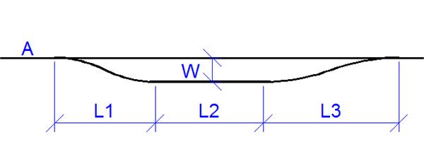

The function constructs a bus stop based on selected parameters and a baseline in the drawing.
MOUS_ICO Menu: Landscape > Construct Lines and Polygons > Bus Stop
MOUS_ICO Toolbar: Construct Lines and Polygons:
 Bus Stop
When starting the function, you are first asked to pick the baseline. Pick baseline: Select a line, arc, or polyline in the drawing.
The dialog box appears with the parameters that define the bus stop. All parameters are in meters:
A - Baseline W - Width L1 - Expansion, St L2 - Invariable, Lm L3 - Constriction, Sl
