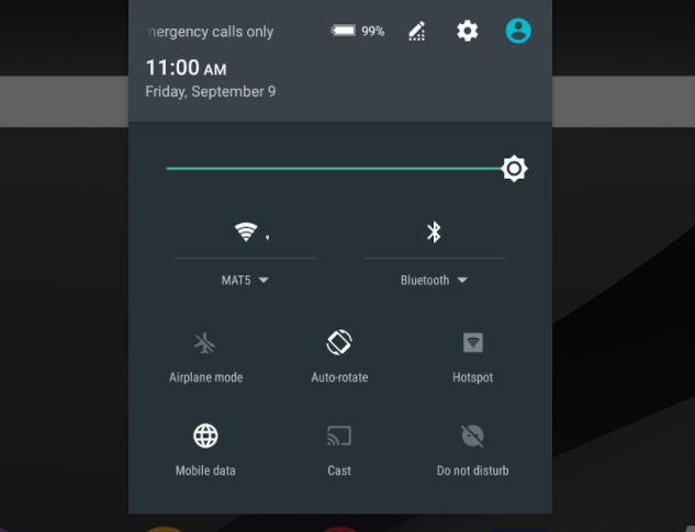

  2. Drag down from the top of the screen to reveal the status bar with Quick Settings icons.
    QuickSettingsStatus

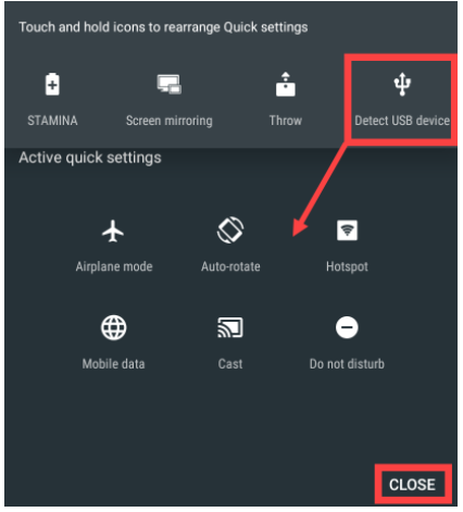

  3. Tap the Edit Quick Settings icon.
    QuickSettingsIcon
  4. Tap and hold on the “Detect USB device” icon found in the top row of the window and drag it to the lower portion of the window (Active quick settings). Tap Close.
    DetectUSB

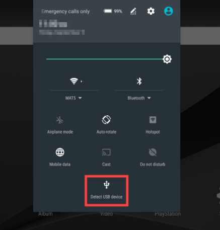

  5. Tap “Detect USB device” from the Quick Settings area of the status bar to detect the Catalyst antenna.
    DetectUSBDeviceOption

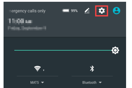

  1. Repeat steps 1 & 2 listed above
  2. Tap the Settings icon

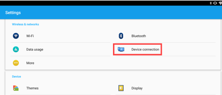

  3. Tap “Device connection.”
    DeviceConnection

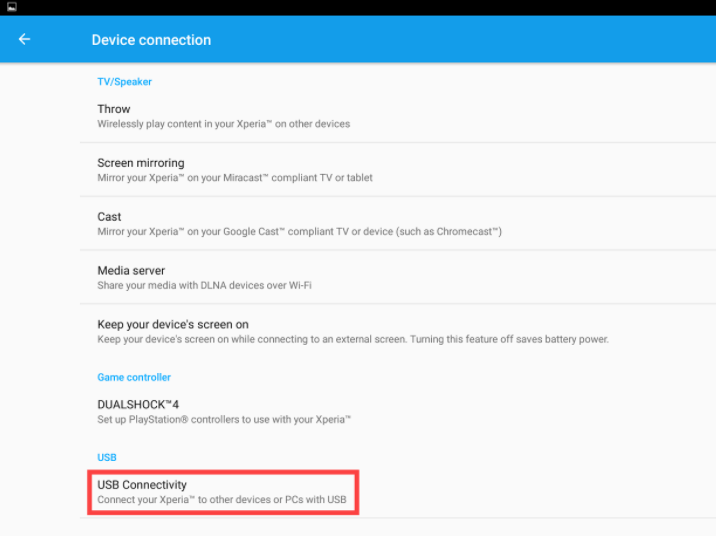

  4. Tap “USB Connectivity.”
    USBConnectivity

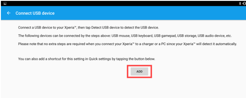

  5. Tap “Tips for connecting with USB device.”
    TipsForConnectingDevice
  6. Tap “Add” to add the “Detect USB device” icon to the Quick Settings status bar.
    AddDetectUSB
  7. Tap “Detect USB device” from the Quick Settings area of the status bar to detect the Catalyst antenna.
    DetectUSB
