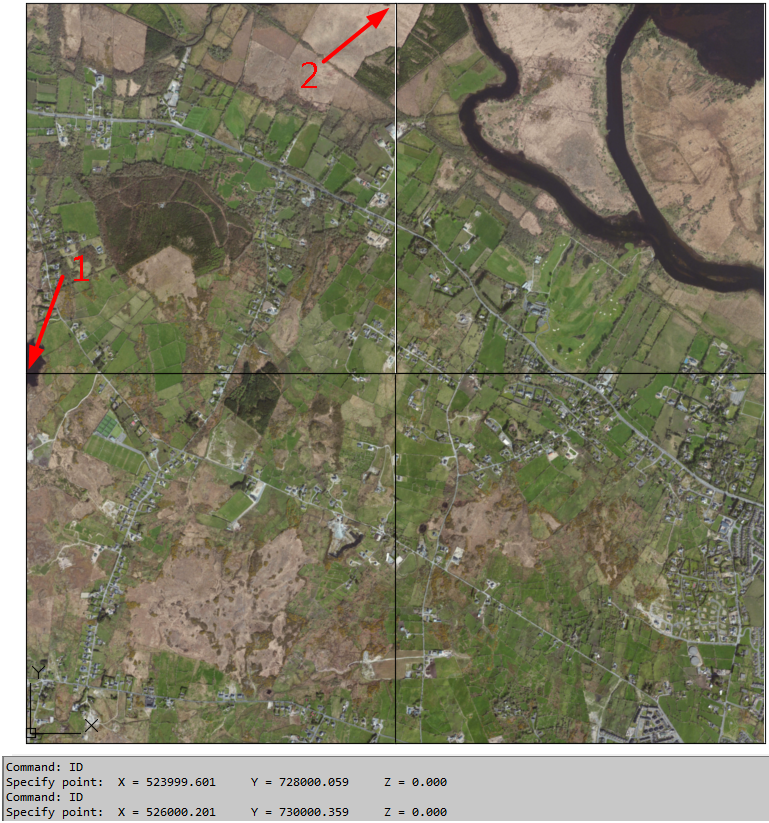

In AutoCAD open the DWG where the ortophoto(s) are inserted. Use ID command and click bottom left and top right corner of each ortophoto frame. Write down the coordinates.

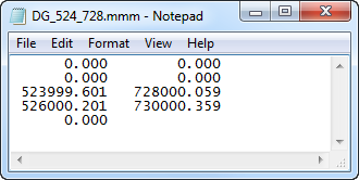

Open a text editor program like Notepad on your computer, and make a text file like this for each of the ortophotos:

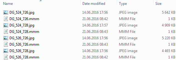

Save each of the files with the same name as the JPG, but with extension *.mmm. The folder with the files (image- and coordinate files) should look like this:
