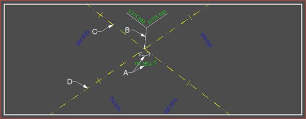

Pick where to locate label:
MOUS_ICO Pick the location for the label (chainages of the intersecting lines/alignments at the intersection)
Pick where to locate angle:
MOUS_ICO Pick the location for the intersection angle
Figure: Illustration for Label at Intersection of Lines/Alignments
