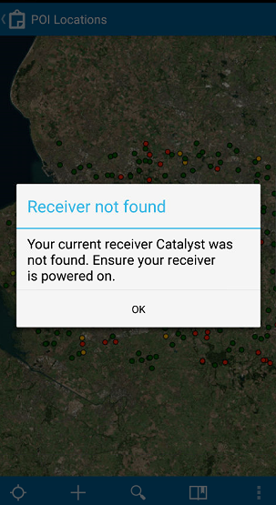

You open a Map in Collector and see the following error
Receiver not found: Your current receiver Catalyst was not found. Ensure your receiver is powered on

The error message in this case simply means that ESRI Collector cannot connect to the Catalyst service because the connection is already in use by another application
Solution
- Select OK to the Receiver not found message prompt In Collector
- Close out of the current map and revert to the Collector map gallery page
- Open TMM (or your other Catalyst enabled application) and disconnect Catalyst using the slider bar
- Reopen Collector and open your map, this will successfully reconnect to the Catalyst service
