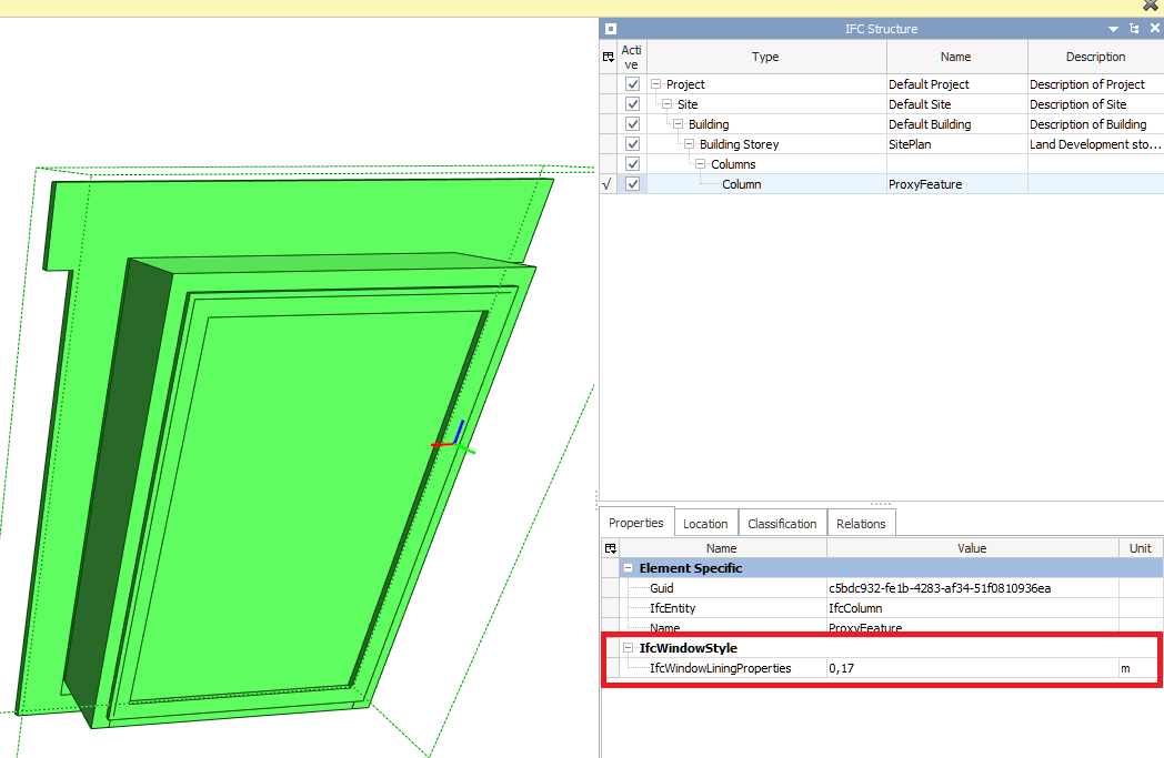

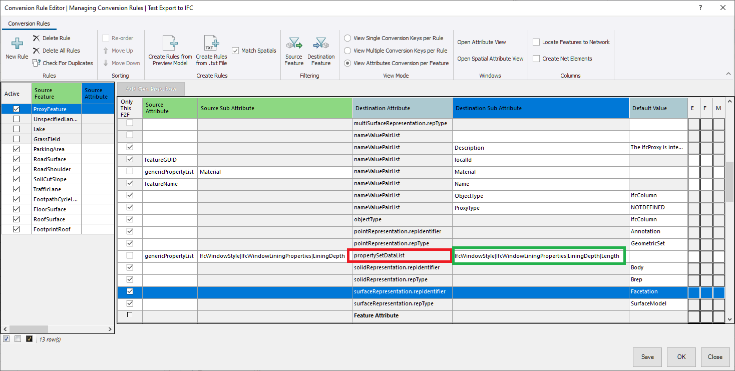

In IFC export, how to change values of attributes between comma and punctuation
Answer: You can change conversion rule by adding suffixes at the end of a property name. Some suffixes are VOLUME, LENGTH, AREA, ANGLE, MASS. In example under, length is used.
