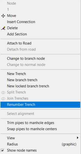

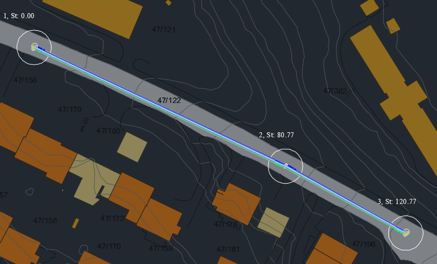

Navigate to your trench:
Right click on the node you want the numbering to start from. Select Renumber trench:

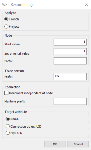

The following window will appear:

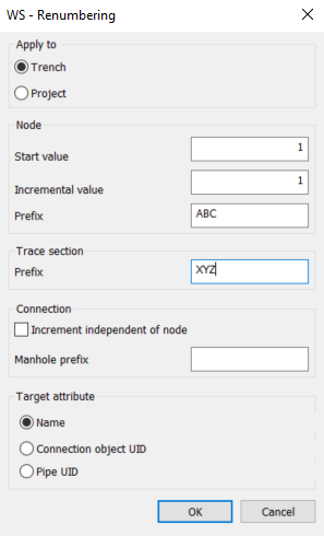

Prefix will change the names. First for the nodes, and then for the trench.
Here, the node names will be ABC and the numbering will start with 1 at selected node and increase with one to the next node.
The trench name will be XYZ.

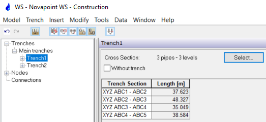

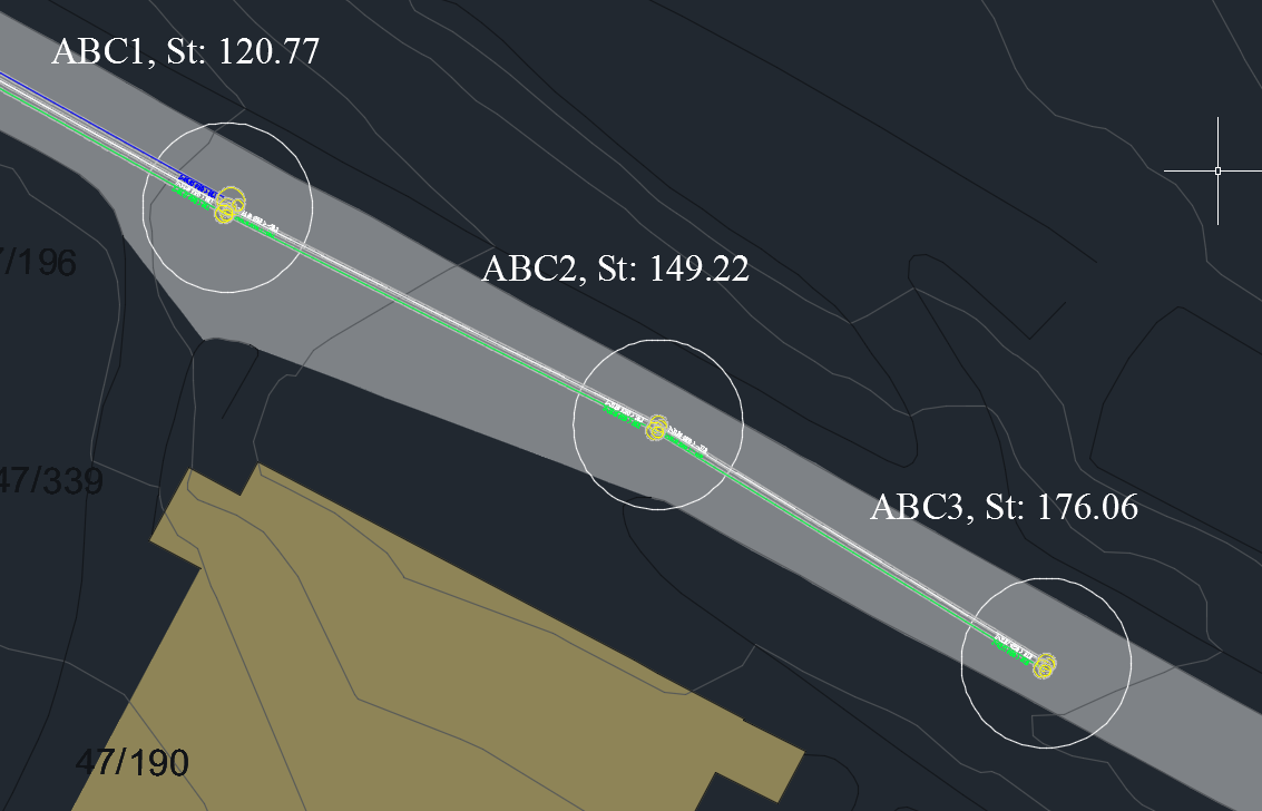

This will result in:
You can see the change trench name in the design window
