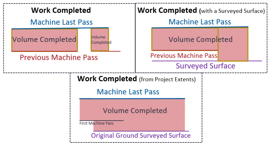

How does the ‘Work Completed’ volumes calculation work?
Answer:
Work Completed calculates the volume remaining ‘From’ a Previous Machine Pass surface ‘To’ another machine surface. This calculation indicates how much volume has changed between two machine surfaces, i.e., how much volume was completed from one surface to the other. When a Surveyed Surface is included, it will also calculate the volume between the surveyed surface and the design boundary. A Project Extents calculation will go back to the first recorded surface for the Project, whether it is an original ground Surveyed Surface or the first Machine Pass, to determine the starting point.
Note: There must be an overlap between the two Machine Passes Surfaces and/or Surveyed Surfaces in order for a volume to be calculated.
