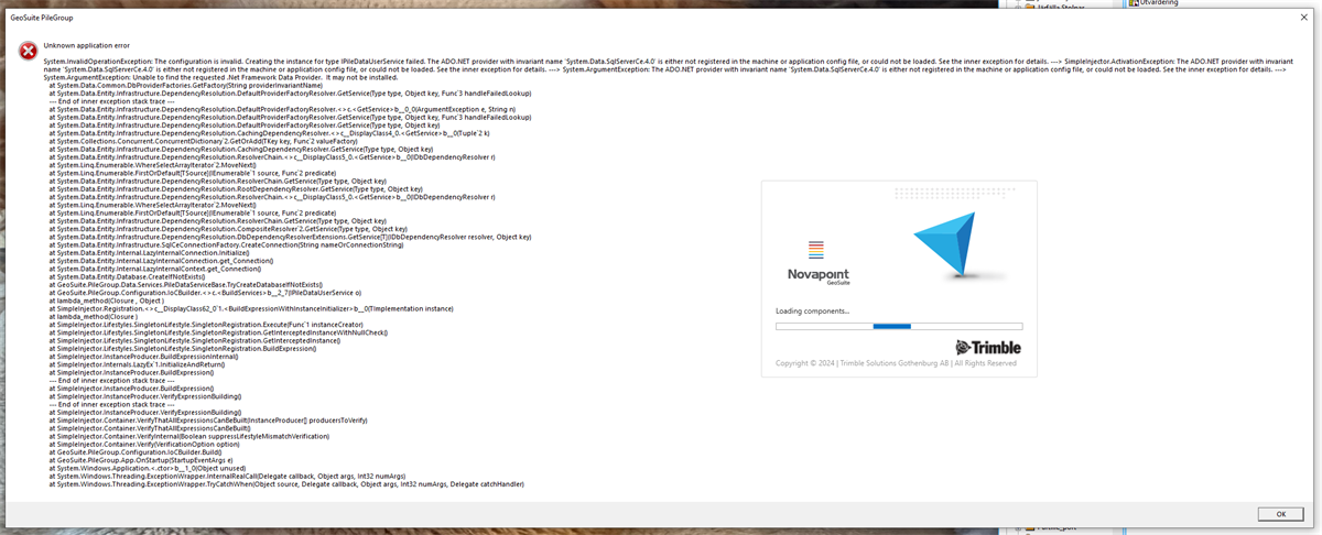

Error Message
When opening and working in Geosuite Piles, the user gets the following error about System.Data.SqlServerCe.4.0:
Unknown Application Error on  System.Data.SqlServerCe.4.0.
Solution/ Remedy
You need to download SQL Server compact CE, you can go to the following link and download it:
https://www.microsoft.com/en-US/download/details.aspx?id=30709
