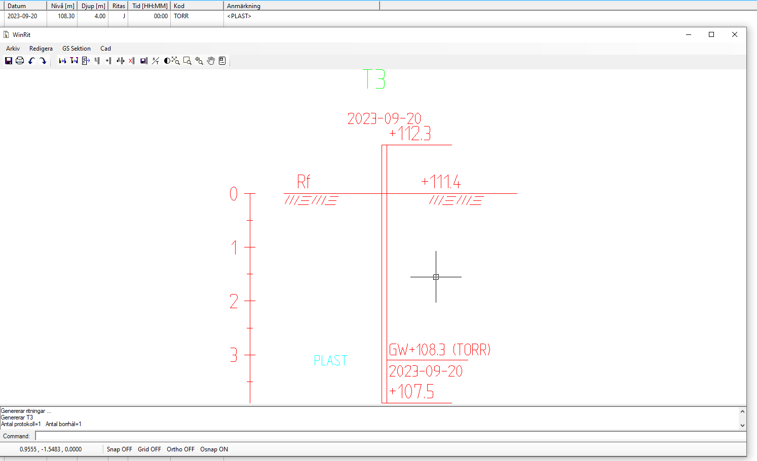

If the user wants to add a comment in a borehole that will be shown in the drawing, eg. plastic groundwaterpipe or dry well, this text should be written as a comment (Anmärking ) in Geosuite Presentation within <> as seen below:
<text>, <plast>...etc.
