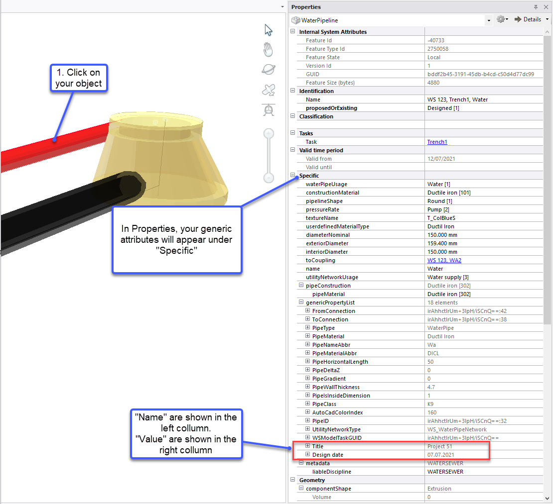

There are several methods to add information to your WS-objects.
1. Add Generic Attributes directly on the trench2. Use Property set Editor
This method is adding information on all objects in that trench, you should only use this method for information that you can add on all objects.
Method:
Choose the trench to which you want to add attributes, then go to settings.
Go to "Generic Attributes" and fill in the collumn "Name" for your attribute.
Then chose Type from the dropdown menu as "Text".
Add the Value for that specific name
Check properties to see the information added to your objects.
With this editor are you able to add generic attributes to all objects regardless of task, and you can easily change values on each object. This method requires a Property set to be predefined in Configuration.
