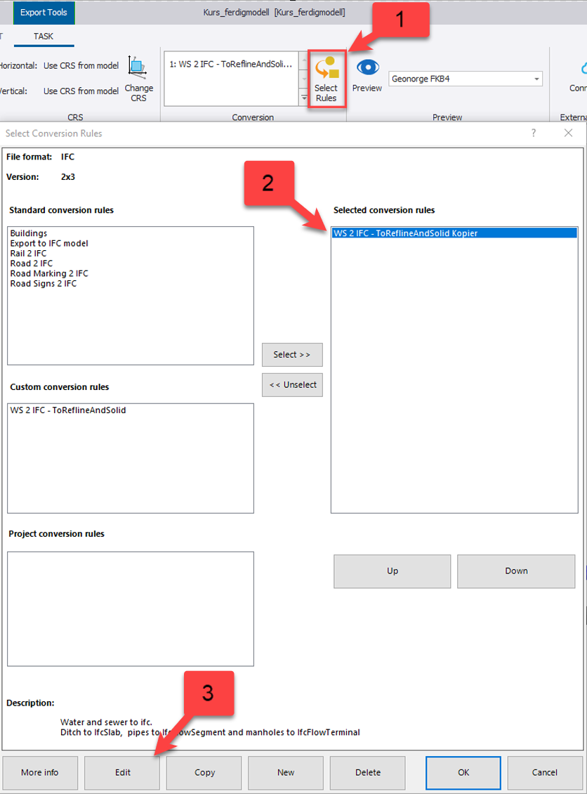

Step 2. Create an "export to IFC" task and press "Select conversion rules"
Picture number 3
Chose one suited conversion rule (for example "WS2IFC" (Water and sewer 2 IFC)) and then press edit.

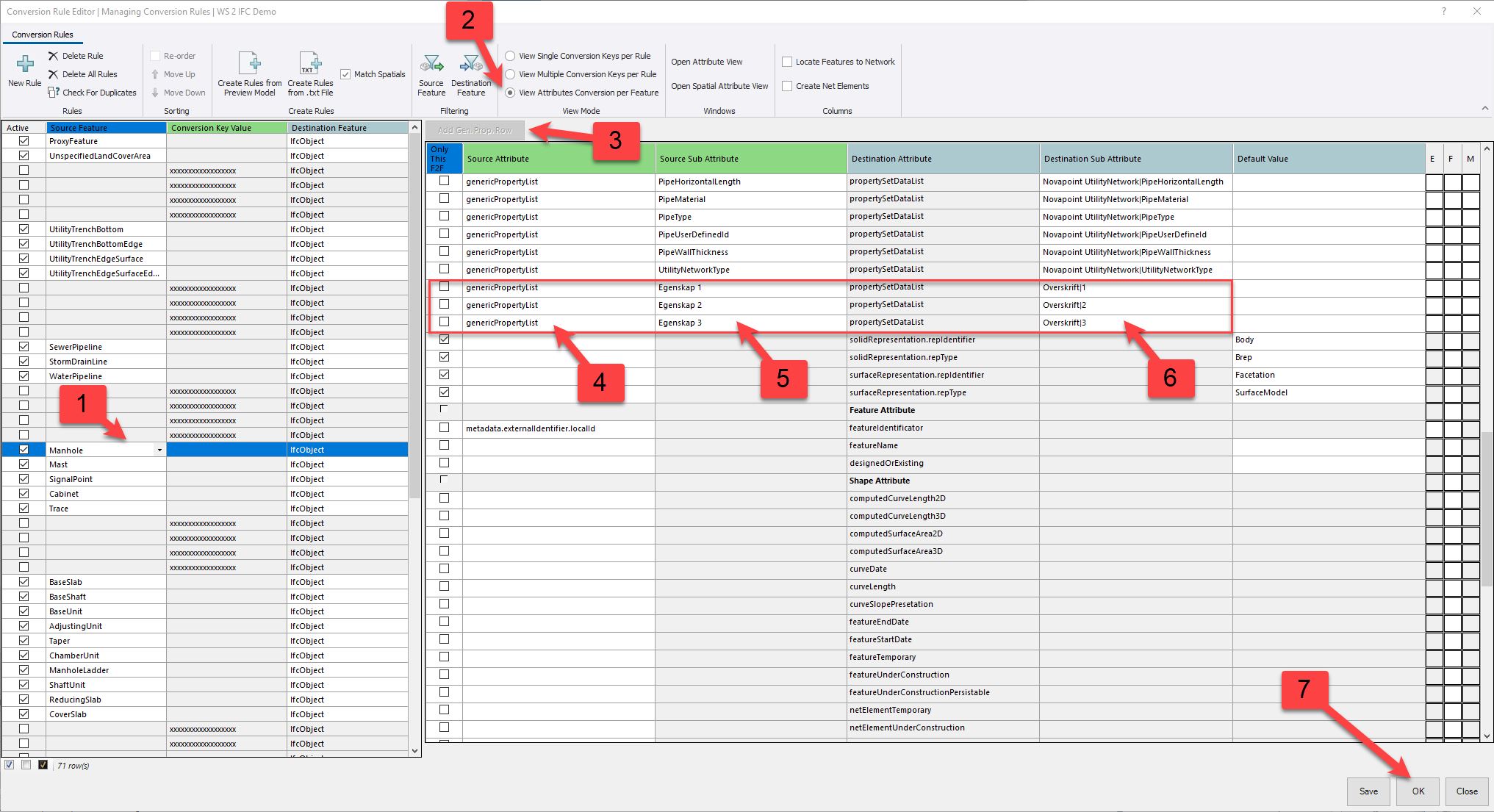

Step 3. Edit the conversion rule
In order to export the properties that you have created, you will have to add this to the conversion rule. You can do this by these 7 steps.
1. Activate the line with "manhole" (we want to choose an object that we know we have added properties too)
2. Then click “View Attributes Conversion per Feature” (the window below will appear)
3. Press “Add Gen. Prop.Row”
4. Use the drop-down menu to choose "GenericPropertyList" (important to use drop-down menu)
5. Use the drop-down menu to choose the property which you have created (see picture number 1 above).
6. Write first the name of the headline you want for your properties, then separate by adding this symbol | (vertical line) then write the name you want for that specific property on the other side of the line.
7. Save the conversion rule and close.

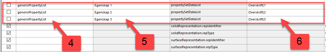

Picture number 4
Picture 4 zoomed.

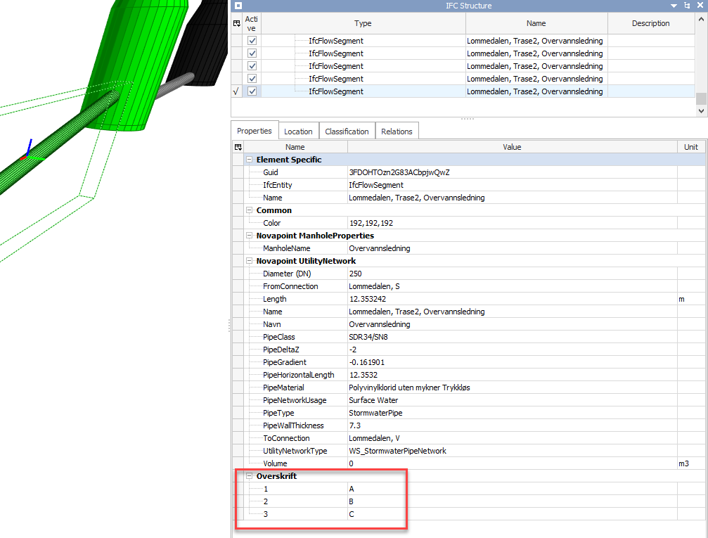

    Step 5. Open the IFC file in a 3D-viewer
    • Notice where the headline «Overskrift” comes from in the conversion rules (the text before this sign| see marker number 6).
    • Notice the headline of each property is called 1, 2 and 3 (this is the text that comes after the sign | in the conversion rule. See marker number 6)
    • Notice the Value A, B, and C, these are the values from the object. This value is read by the software, and will always give the actual value from the property. See picture number 1.
