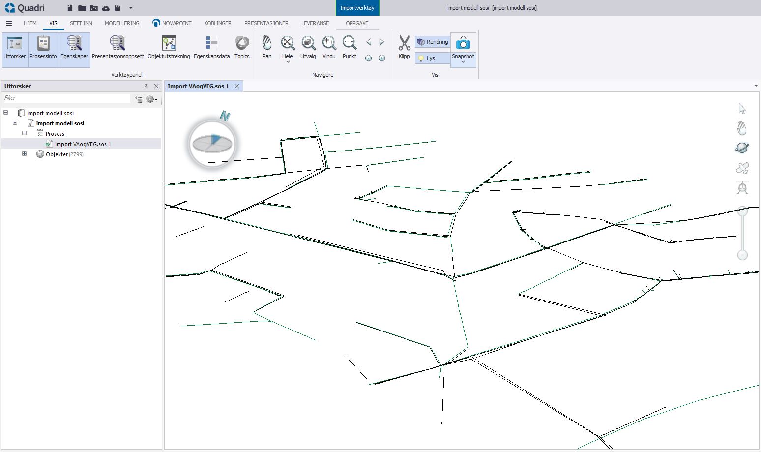

Problem
When importing a SOSI file, there are several points with missing Z-values (often written as zero). When importing it looks like this:
Solution
adjust the settings in the import task to ignore Z-values of "zero". by doing this the picture above can easily be changed to the example below.
