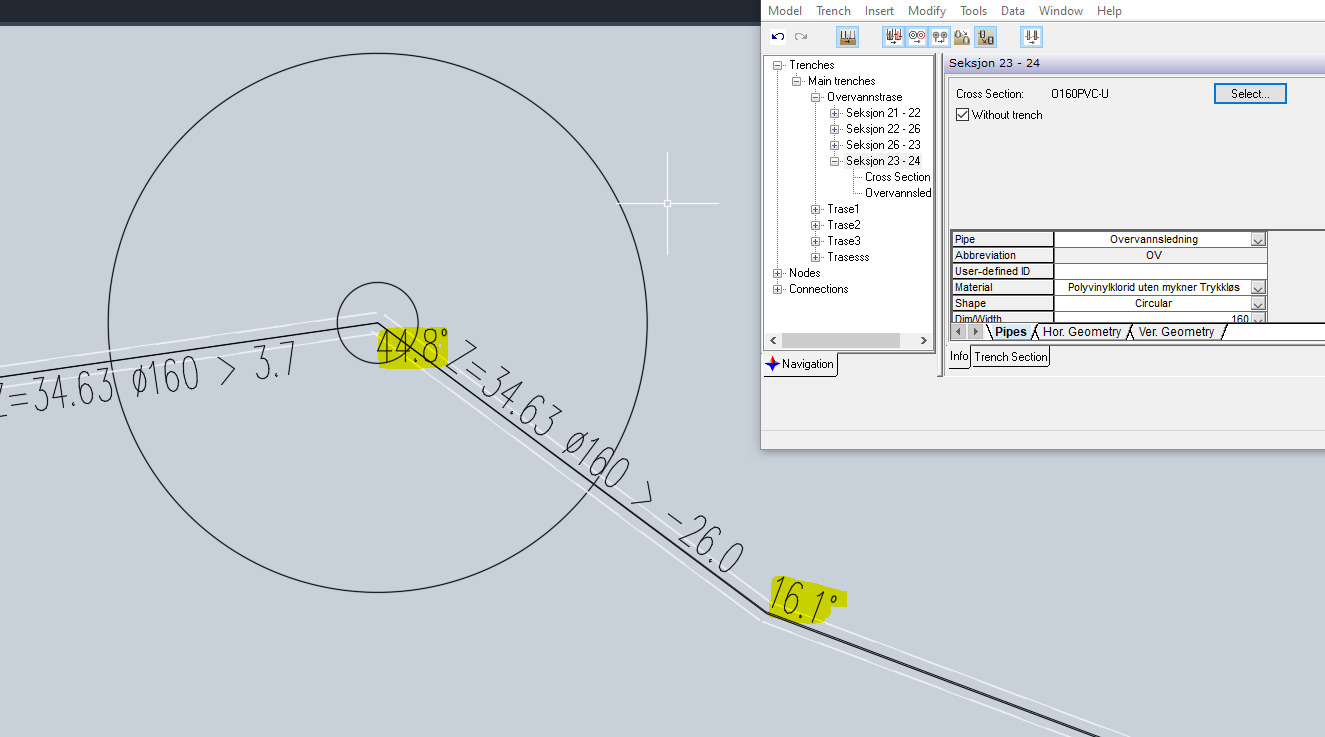

By pressing "Show pipe angles" under tools in the design dialogue you can see the total angle in both connections and vertexes as you design. This makes it easier for you to design standard angles. Its worth noting that this gives you the total angle both horizontal and vertical.
This value is visualized as shown below:
