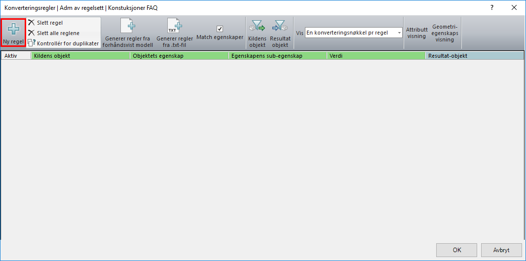

You are now in the Conversion Rule editor. Click New Rule .

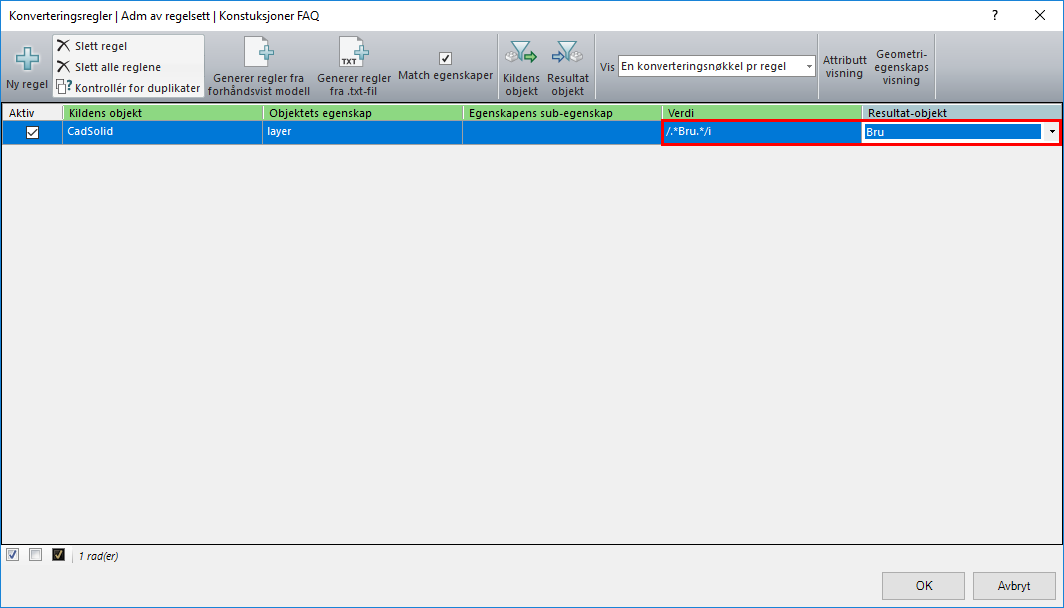

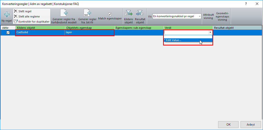

For this example we set up Source Feature = CadSolid and Source Attribute = layer. In Convertion Key Value, click * Edit Value….
Type in Bridge under substring and click OK.
A regular expression for the text string “Bridge” is now filled in. Also set Destination Feature to Bridge. Now, if the text string “Bridge” is somewhere in one of the AutoCAD layer names, it will be mapped to feature Bridge. Since we have a layer name called “1020_K_Bridge_XFP1_K_Concrete01”, this layer will be converted to Bridge.

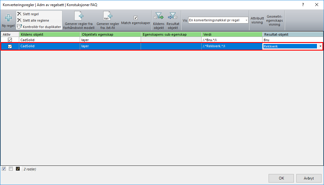

Do the same thing for the Traffic barrier.

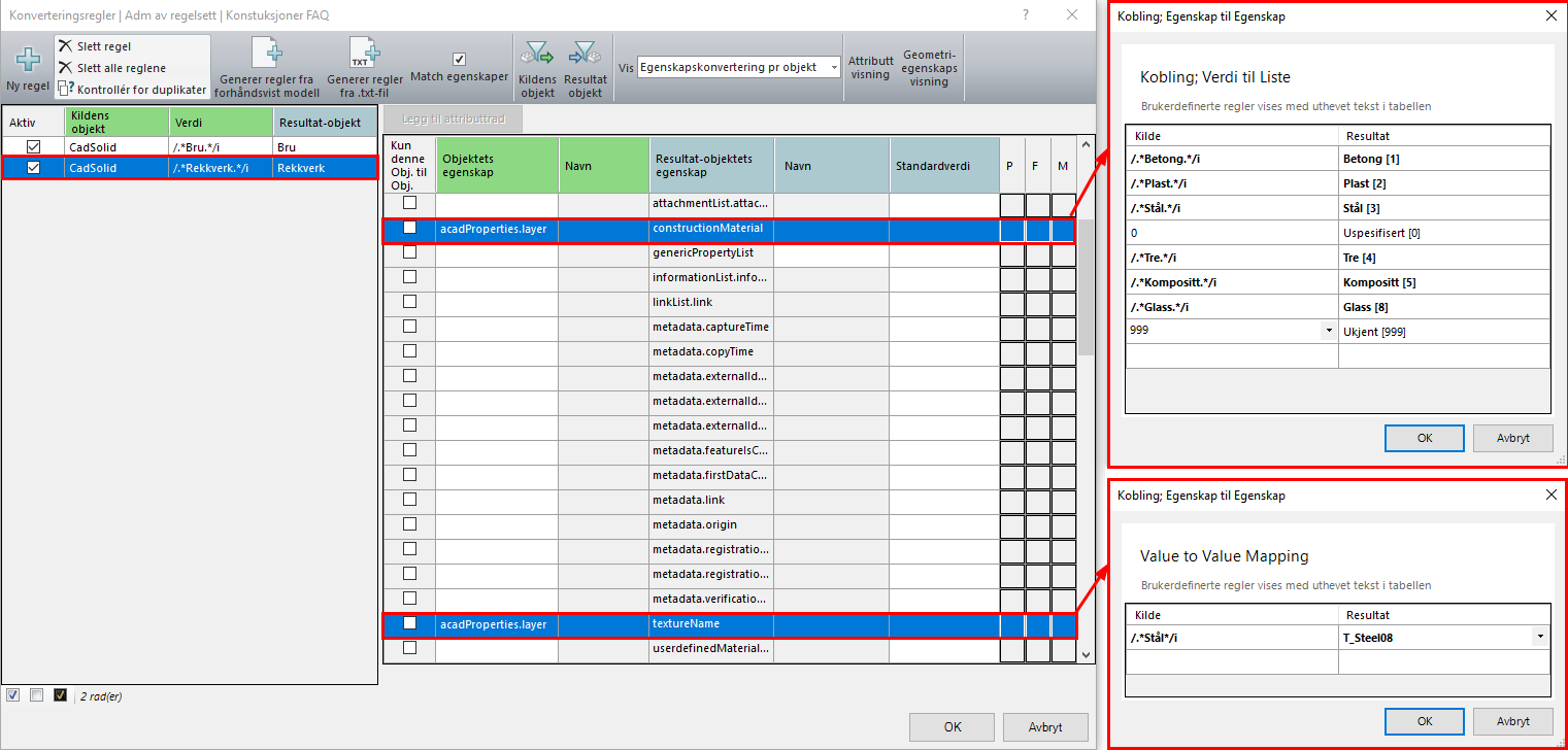

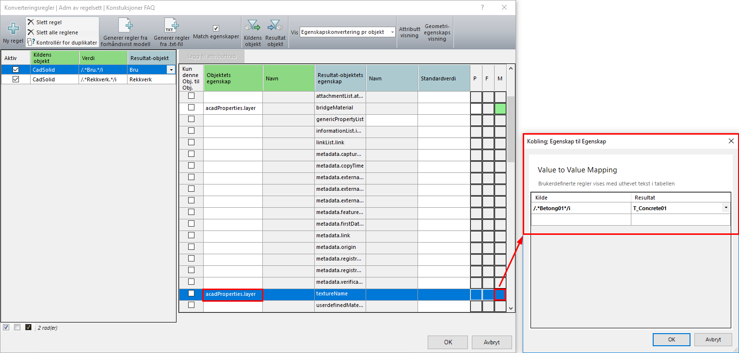

Click Attributes Conversion per Feature (marked yellow in the picture below).
First we add the attribute bridgeMaterial for the bridge. Set up like the picture below shows. bridgeMaterial we get from acadProperties.layer (the AutoCAD layer name).
Click the mapping button to the right in the row for bridgeMaterial. Then we set up the mapping. Set up as the picture below shows, with Regular Expression you can type in yourself (/.*Xxxxx.*/i). In this case, if “Concrete” exists somewhere in the layer name, bridgeMaterial will be mapped as Concrete [1].
Similarly, we add the textureName property for Trafficbarrier. Set up like the picture below shows. we get from acadProperties.layer (the AutoCAD layer name).
Click the mapping button at the right of the row of textureName. Then we set up the mapping. Set up as the picture below shows, with Regular Expression you can type in yourself (/.*Xxxxx.*/i). In this case, if “Concrete01” exists somewhere in the layer name, textureName will be mapped as T_Concrete01..

Now do the same for the conversion of the Traffic barrier. Here, the properties for constructionMaterial and textureName are used. Set up like the picture below shows.

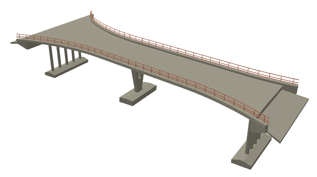

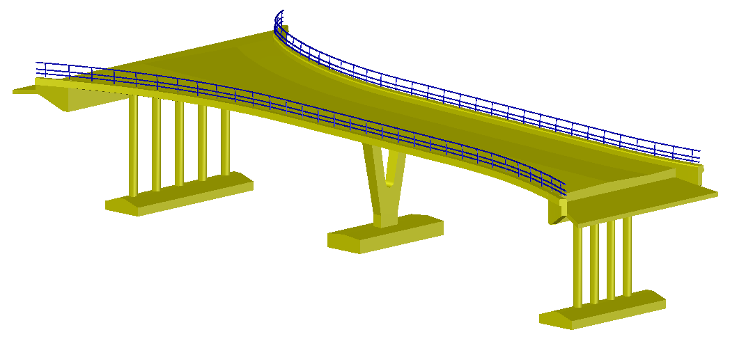

Now we can see the result in 3D. We must select the drawing rule Default, as this drawing rule supports textturing. The end result will be like this:
