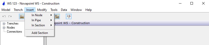

The insert command has these sub-selections:
In node >
Connection
Use this function for inserting connections, e.g. manholes, pipe bends, valves, pumping stations, etc. in a node.
The function is run from the following location:
Menu: Novapoint WS Construction > Insert > In Node > Connection

In Pipe >
Connection
Use this function for inserting connections, e.g. manholes, pipe bends, valves, pumping stations, etc. in a pipe.
Run the function from the following location:
 Menu: Novapoint WS Construction > Insert > In Pipe > Connection

In section >
Node
Use this function for inserting nodes into a trench section.
Menu: Novapoint WS Construction > Insert > In Section > Node

Add section
Use this function for adding a trace section to an existing trench.
Menu: Novapoint WS Construction > Insert > Add Section
