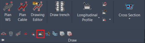

This function can be used to draw a longitudinal profile. To get more options when drawing the longitudinal profile, use Longitudinal profile.
Where
The function can be run from the following location:
How
  1. Start the function
  2. Select trench from dialogue and press OK
  3. Program prompts for:
    'Specify insertion point: '
  4. Program prompts for:
    'Include breaklines in terrain calculation? [No/Yes] <Yes>: '
  5. Program prompts for:
    'Start station (Start point - Endpoint) <0.00>: '
  6. Program prompts for:
    'End station (Start point - Endpoint) <Last selected>: '
  7. Program prompts for:
    'Minimum elevation (terrain: min = 22,55, max = 25.06) <20.00>: '
  8. The longitudinal profile will be drawn
