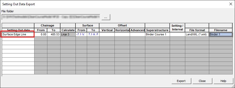

Compared with Novapoint 20 and earlier
When comparing with Novapoint 20 and earlier this format was produced through the Setting Out Data export dialog found in either the road task or the old road tool.
