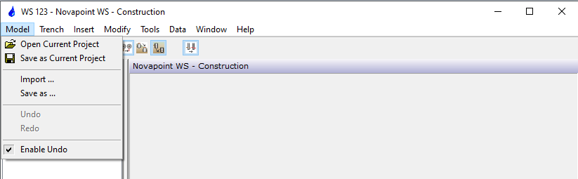

Model
This menu has the following sub-selections:
Open Current Project
The function opens the current WS-project after changing Novapoint projects.
Save as Current Project
The function saves the current project to the base file attached to the project through project settings in Novapoint. The current WS-project can any time during the work be saved as “Current project”.
The same result is achieved by clicking Save at the bottom of the dialogue box.
Import
Import an XML file from a previous saved WS-task (using the "save as" function"
Save as
Save and export your trenches as an XML file. Can easily be imported to other tasks.
