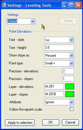

Starting the function opens the dialogue Settings - Levelling Tools. There are two different default styles and we may add a number of our own. These styles will follow the dwg file.

We start with two different default styles - “Default” and “Default - existing”. The style “Default” is the active default style and defines the appearance of point elevations and slope arrows set out in the drawing. The exception will be point elevations from terrain model - created from the use of functions Point elevation from terrain or Point elevations from terrain (grid)...
Create new style
We may however create new styles from our “Default”-style:
  • Double click in the drop-down list when the style “Default” is marked.
  • Type a new name and set the new parameters under “Point elevations”.
  • When all parameters are set, press OK'-button - the new style is created and automatically set active.
All the new styles will be found in the drop-down list and may be selected to be set active. These styles will follow the dwg file.
“Default - existing” can not be multiplied - change parameters directly in this style if you want another appearance for existing point elevations. This style will never interfere with ordinary point elevations.
Tip: Every point elevation belongs to the style that was active when set out. If parameters are changed inside a style - point elevations will change accordingly.
Use the 'Delete'-button to delete styles. This does not apply to “Default” or “Default - existing”

Text - style
The function uses AutoCAD text styles. Choose the style from the drop-down menu
Text - height
Type the text height (mm in the printed drawing). The value must be defined correctly according to window settings. The text height will relate to the Novapoint scale.
Show slope as
The slope may be formatted as a percentage or a fraction.
Point type
It is possible to choose “+” and “X” in different sizes.
Precision - elevations/slopes
Type the number of decimals to be written in the drawing to decide the accuracy.
Layer - elevations/slopes
Set layer name and color for point elevations and slope arrows. Color will follow the layer! If two different styles have the same layer name but different layer colors - the active style will set the color to point elevations in both styles!
Attribute
It is possible to set attributes like underlines, parentheses, and boxes, manually with functions Change to point elevation retained, Change to point elevation omitted, and Terrace height. However, we may also let this be automatically defined in our styles. The option 'Ignore' is set default - manually created attributes will not be affected then.
Follow Novapoint scale
Point elevations will always follow the active Novapoint scale when set out. If the scale is altered, point elevations already in the drawing will maintain their size, whereas new ones will get their size according to activ scale. By selecting 'Follow Novapoint scale', point elevations will automatically change size in the drawing if the scale is altered.
Apply to selection
Use this button to select point elevations in drawing to be part of the selected style. This style will also be set active.
