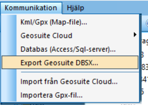

Can I export data from the current Geosuite presentation to this version?
Yes, first make sure that you use the latest version of Geosuite (or atleast 2020.0.12).
Open Geosuite Toolbox, select a project in the left-hand menu and then in the menu under Communication -> Export Geosuite dbsx.
Thereafter, select a folder where the .dbsx will be placed. If you receive warning messages, e.g. coordinate system is not defined, fix the warnings for the project to be able to proceed.
Open next gen Geosuite Presentation (Desktop application) or navigate to the web application. Then select 'Import .dbsx' and select the newly exported file. Geosuite will then start the import process which can take around 20-30 seconds.
