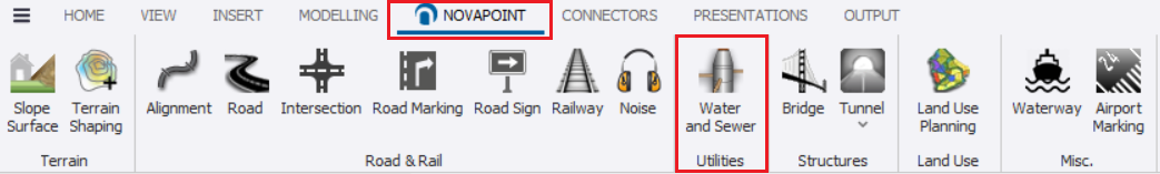

  1. Navigate to the Novapoint ribbon and open a new Water and Sewer subtask

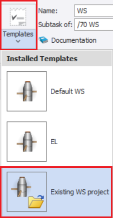

  2. Click on Templates and open Existing WS project

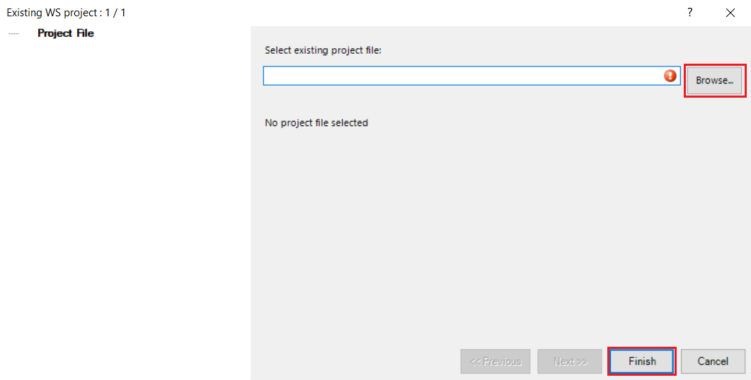

  3. A dialogue will open. Browse to the folder where the existing WS-model (*WS-XML) is saved
  4. End with finish
