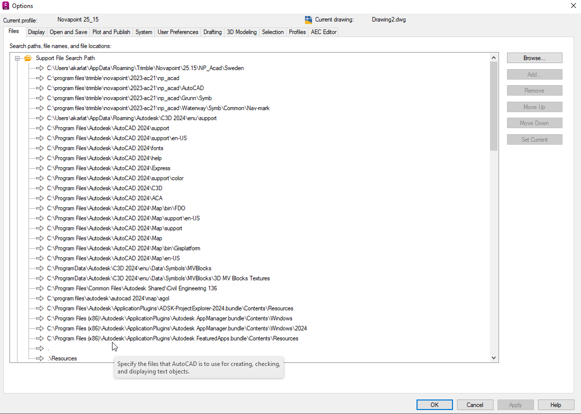

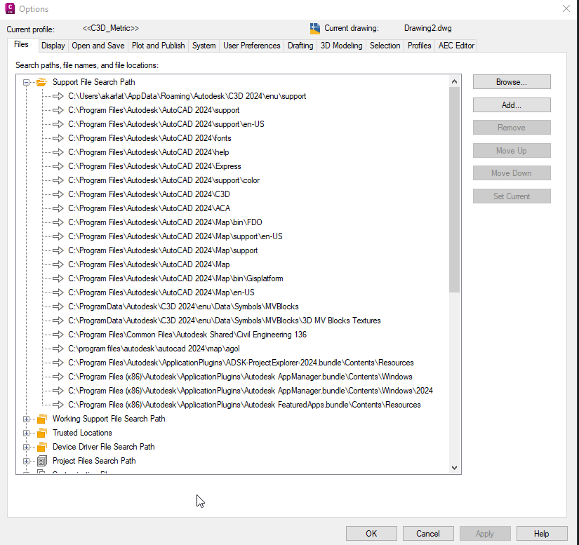

The user has not used GS default font or runs the software through Novapoint, Autocad ISO-font is wider than ours.
The user need to change the font in CAD in this case.
This depends on the path to files in AutoCAD settings. So, if you run via the Novapoint profile, it has set its own path higher than AutoCAD's
The GS does nothing on this. It only delivers an iso.shx
Go to AutoCAD command- Options.
Novapoint delivers its own Profile for settings and with paths to NP before AutoCAD.
