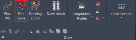

Where
You can start the function in the following location:

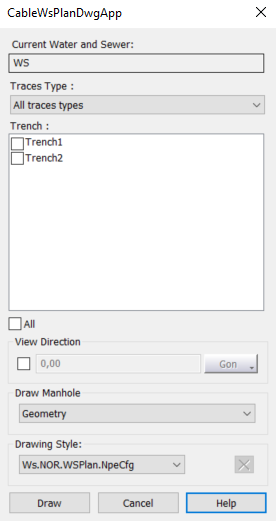

When you start the function, the following window will appear:
  1. Select the trenches to display
  2. Select rotation
  3. Choose between geometry or symbol for the manhole display
  4. Choose drawing style
  5. End with draw
  6. Use the drawing editor to edit the drawing
